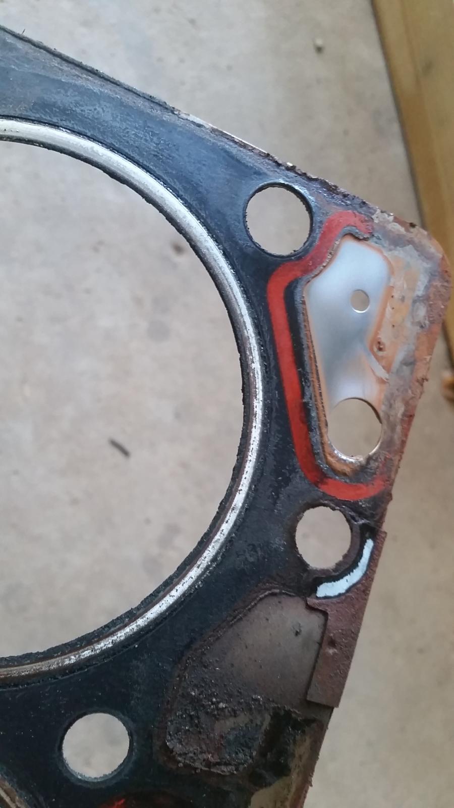

Got the head off today with the only issue being two broken manifold bolts.

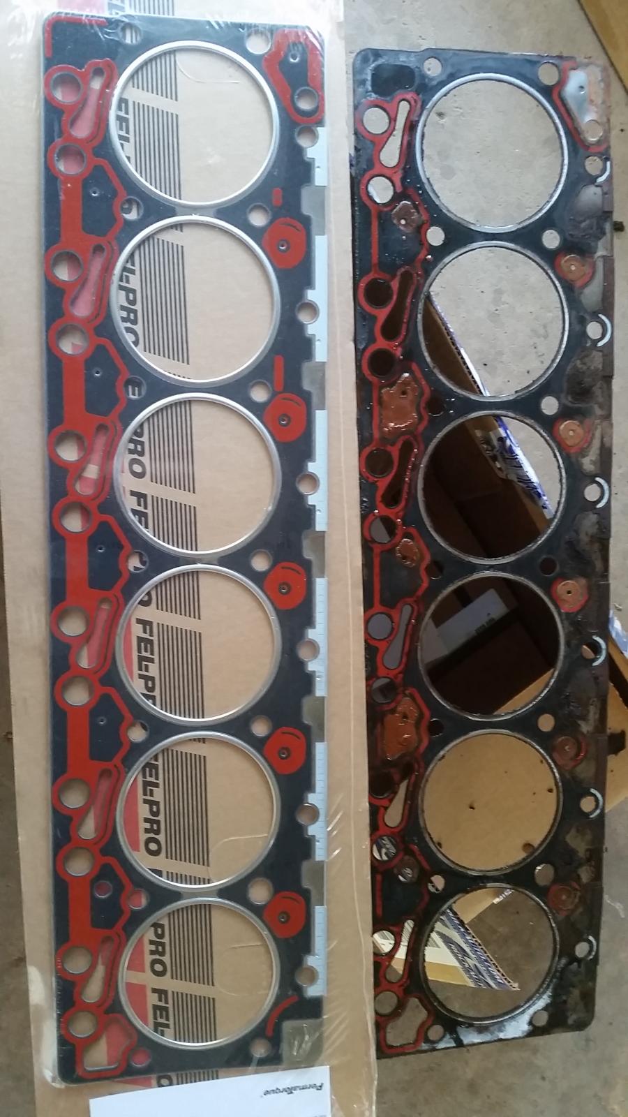

It appears that the head gasket has been replaced somewhere along the line with the crappy Fel-Pro gasket. It's easy to see why I was leaking water so bad.

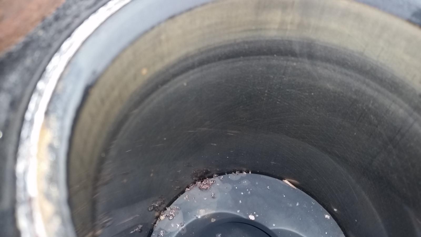

The cylinders all looked great, especially for 300k miles.

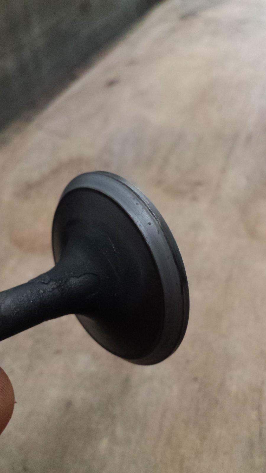

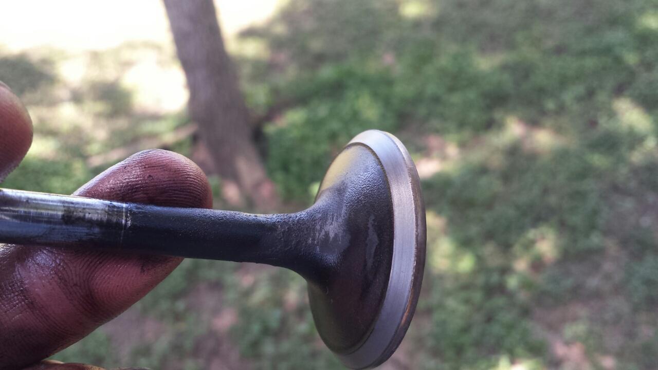

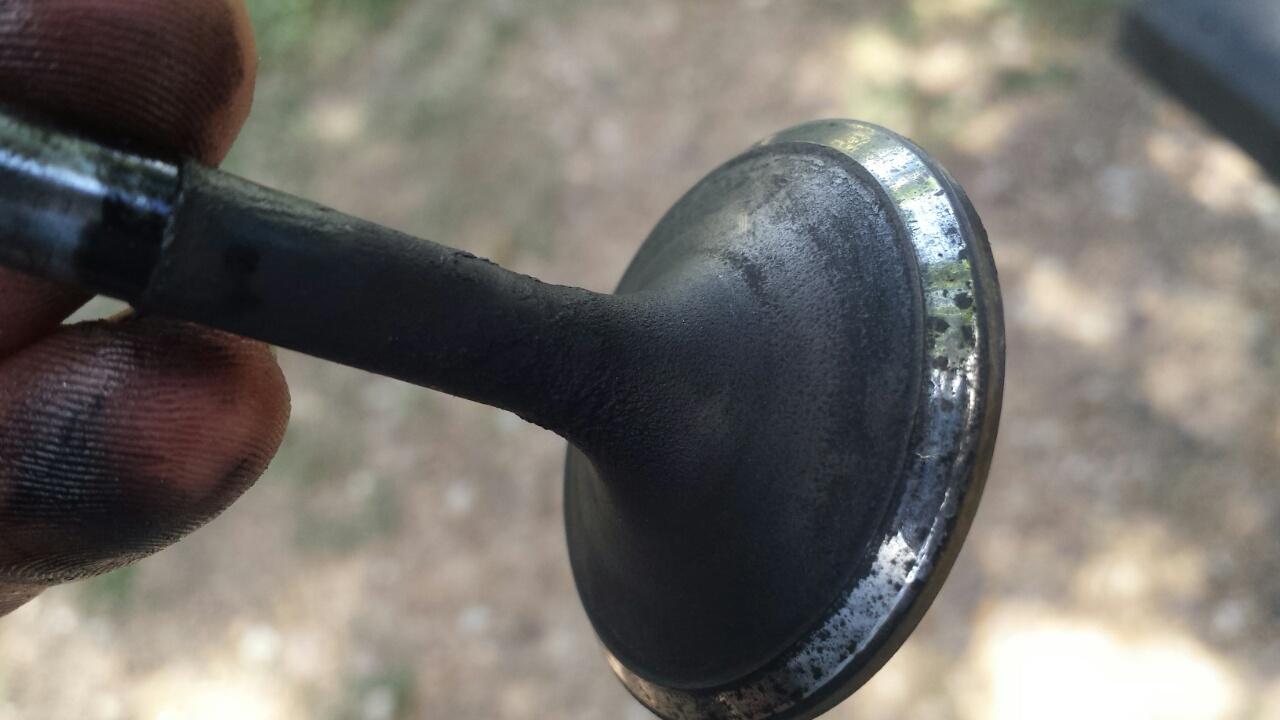

I forgot to get pics of the valves and valve seats but they looked really good as well.

9 minutes ago, Mopar1973Man said:
Coolant pH did help that gasket to fail...
I don't doubt it. I've been fighting rust in the coolant system since owning the truck. I've flused the system until the water comes our crystal clear, fill with premix and a month or so later it's brown again :doh:
