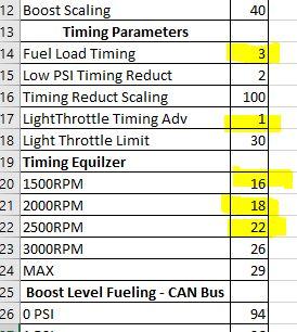

Again the confusion sets in.
On 3/21/2018 at 9:13 PM, Me78569 said:
So 5* timing reduct and %50 scaling gives you 2.5* max timing pull.
So 5* timing reduct and %30 sclaing givees you 1.5* max timing pull.
So 5* timing reduct and %70 sclaing givees you 3.5* max timing pull.
But you look at your graph...
In all cases, it's 2.5* timing pull. But above you stating 1.5, 2.5 and 3.5* of timing pull?
Maybe why I never play with this setting because I still don't understand the math behind it and how it functions.
Those are 2 different examples.
Example 1
scaling sets a max amount based on the timing reduct
Example 2
the graph is comparing 2.5* of timing reduct at %100 scaling to 5* reduct at %50 scaling.  See how they both end up at 2.5* pulled max, but the 5* with %50 scaling hits that 2.5* of pull faster?
Quote
The key is how fast timing hits that point. in this example we have 2.5* timing reduct %100 scaling vs 5* timing reduct %50 scaling.  same total pull in timing, but the 5* %50 scaling hits peak timing pull at %50 tps input

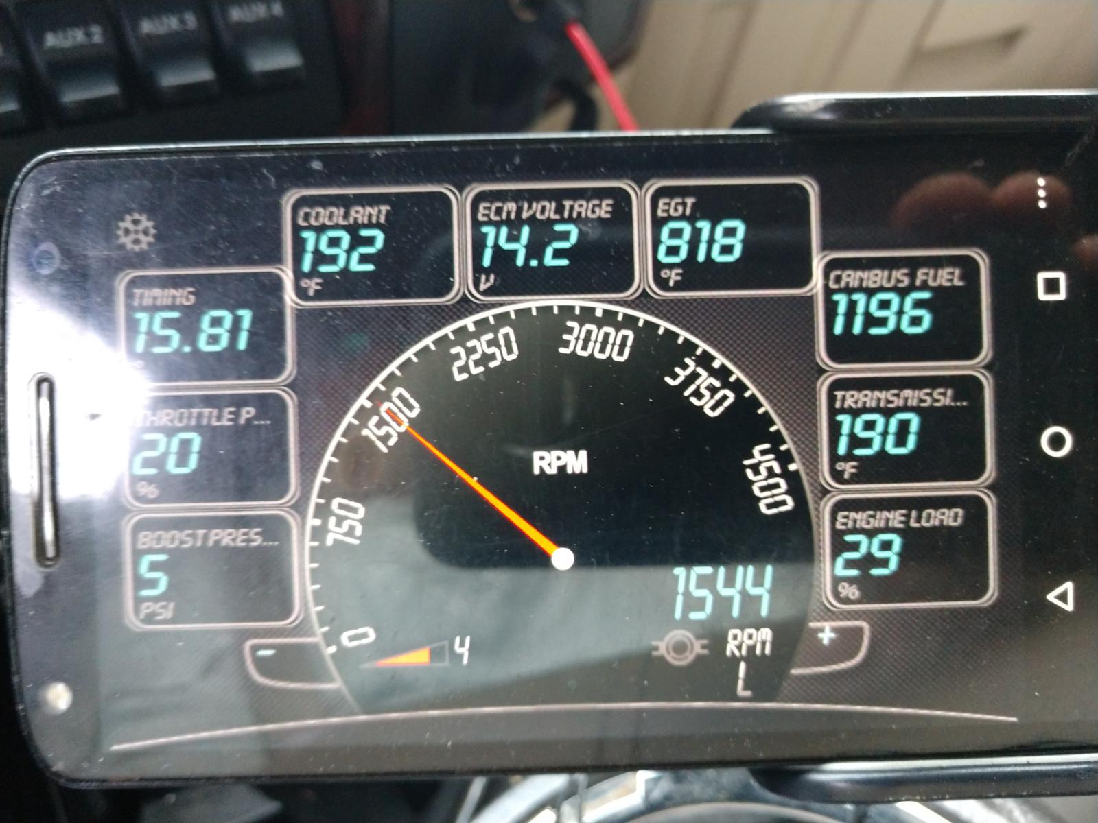

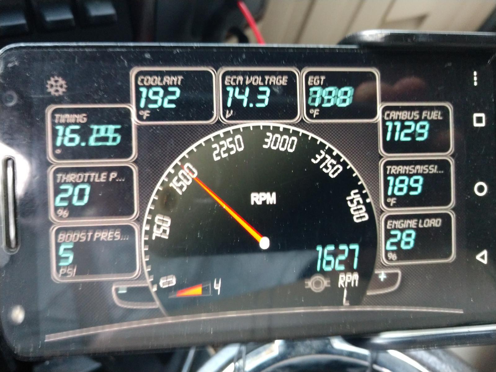

So I was just over looking at the threads on 24v section, and noticed the one about AC noise interference with the ECM and VP. Since I have a conversion, I'm using the Ford alternator and charging system. I also deleted the heater grid on the Cummins. The reason I bring this up is I am still having the bucking issue. When I run it on level zero, it happens very slightly, mostly at 1500 - 1600 rpms, 25% load, and 55- 65 mph. Mind you the timing is stock. As soon as I take it to level 2 or 3, the bucking gets more prevalent, and I'm down to 14.5 in the timing. Now as soon as I hammer the throttle it seems to stop the bucking, or should I say it comes out of it. Now on levels 4 and 5, as soon as the wire tap starts to come on it really bucks, and puffs smoke. Not a steady stream of black. Then the turbos start to clear it up and it runs ok, not great. So my point is, this issue seems to have just started little by little, is there anyway I can check for the AC noise? Could I unhook the big wire from the alternator and see if that helps? In other words just run off the batteries. This gremlin is really kicking my arse, and also it is a reman vp44, I got from XDP. Any suggestions will be greatly appreciated, and thanks!
If by 'bucking' you mean the converter is locking and unlocking rapidly then yea, could be your ALT and removing it from the equation while driving will prove that or not. If the 'bucking' is more like surging, then I'd say you're still fighting tuning issues in those scenarios you described.
Yes it is a surging issue, my convertor doesn't lock till it's in od. Try to get the tunning on the engine figured out before I try locking it in other gears.
if the issue is there on stock level, even a little I start to think it is fueling related.
