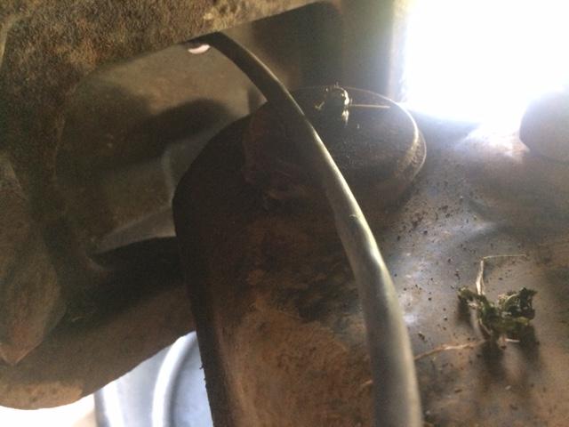

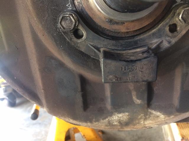

Got wheel AND hub off, mine is obviously an older one when compared to your article on changing sensors. My luck.    There is no metal tab on top sensor.  Sensor is located at bottom, with 2 bolts holding it on. Have not taken 2 bolts off, but it appears I have the wrong parts.  You mention tone wheel failed.  Was it missing a tooth or what?  Mine was covered in dirt and debris.  I cleaned it up.  All teeth are present, square, no signs of physical damage.  Is this an either work or doesn't issue?  Previous owner used a red grease.  Any recommendations on type please.  Thanks. Leaky
Well, that what I thought too. It actually the spot welds break free and the tone wheel spins or the tone wheel is too far from the sensor. Still to fix mine was to replace the right side wheel bearing to resolve the issue.
OK.  I'll take it one step at a time on the tone wheel.  Nothing wrong with cleaning it up I hope.  Take a look "my" sensor.  Been to a lot of websites and never once was this displayed as an option for an ABS Sensor for my truck. I'd just be happy finding a source right now. :)

UPDATE:
It appears a company called AIP Electronics makes these sensors.  Nothing $150 won't take care of.   Part number on Sensor proper is  KH 21A9 and a 14A9.  Initially I thought KH stood for Kelsey Hayes but that didn't wash.  During all the research I found a Sensor for a 99 3500 listed as LF ABS106 RF ABS107 by AIP.   So, I'm in the holding pattern again.  It gets better.  The starter is dead on the Zero Turn so the grass will continue to grow.
