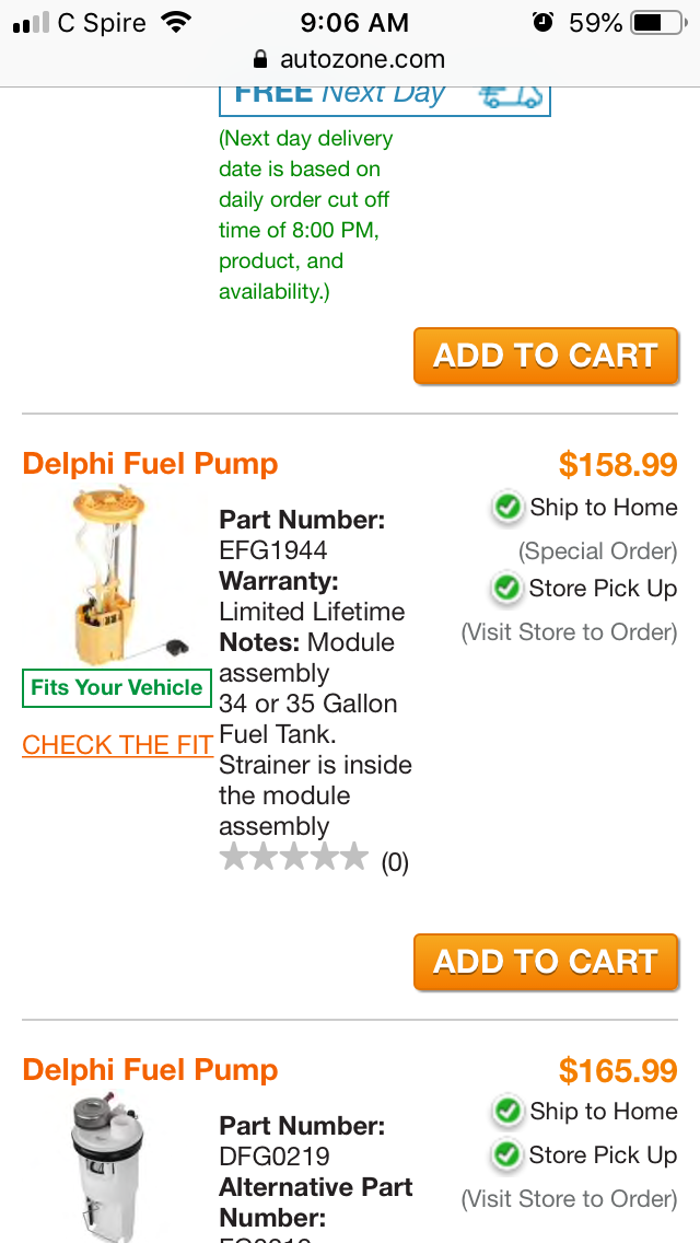

i have had to depend on other people wayyyy too long, yall will prolly not like this, i have to get this truck running, for the time being i may have to get a delphi lift pump. oem design. hopefully it will last until the tax man comes!!! i just hope that will solve the fuel pressure/dying thing for now.
question is, how can i wire it to relieve the ECM, will it crank if the ECM foes not find a lift pump?

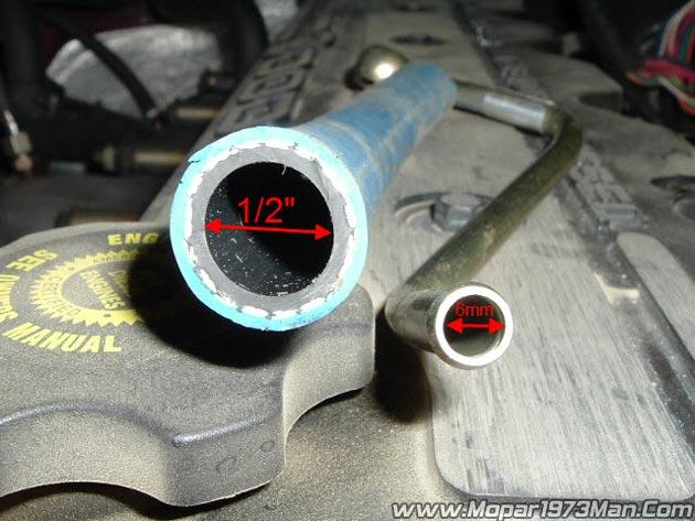

I would skip the DDRP because that will not deal with the plumbing issues. The pump tend to fail premature because of restriction stress placed on the pump being they are still sucking through the same 6mm ID lines and still mounted on the block then trying to pump through a 6mm ID line and banjo bolts. None of the DDRP pumps are quality units sorry to say.
The only solutions I would suggest is Full AirDog, Full FASS or Fuel Boss mechanical pump. Any of these kits will replace all the plumbing and the pickup assembly. Basically, you need to ditch all the stock plumbing from the fuel tank to the VP44. Like myself, I've got an AirDog 150 that is heading for 13 years old and has over 250k of service. The pump head was replaced once. Maybe that's why my last VP44 lasted 243k miles. :whistle:
