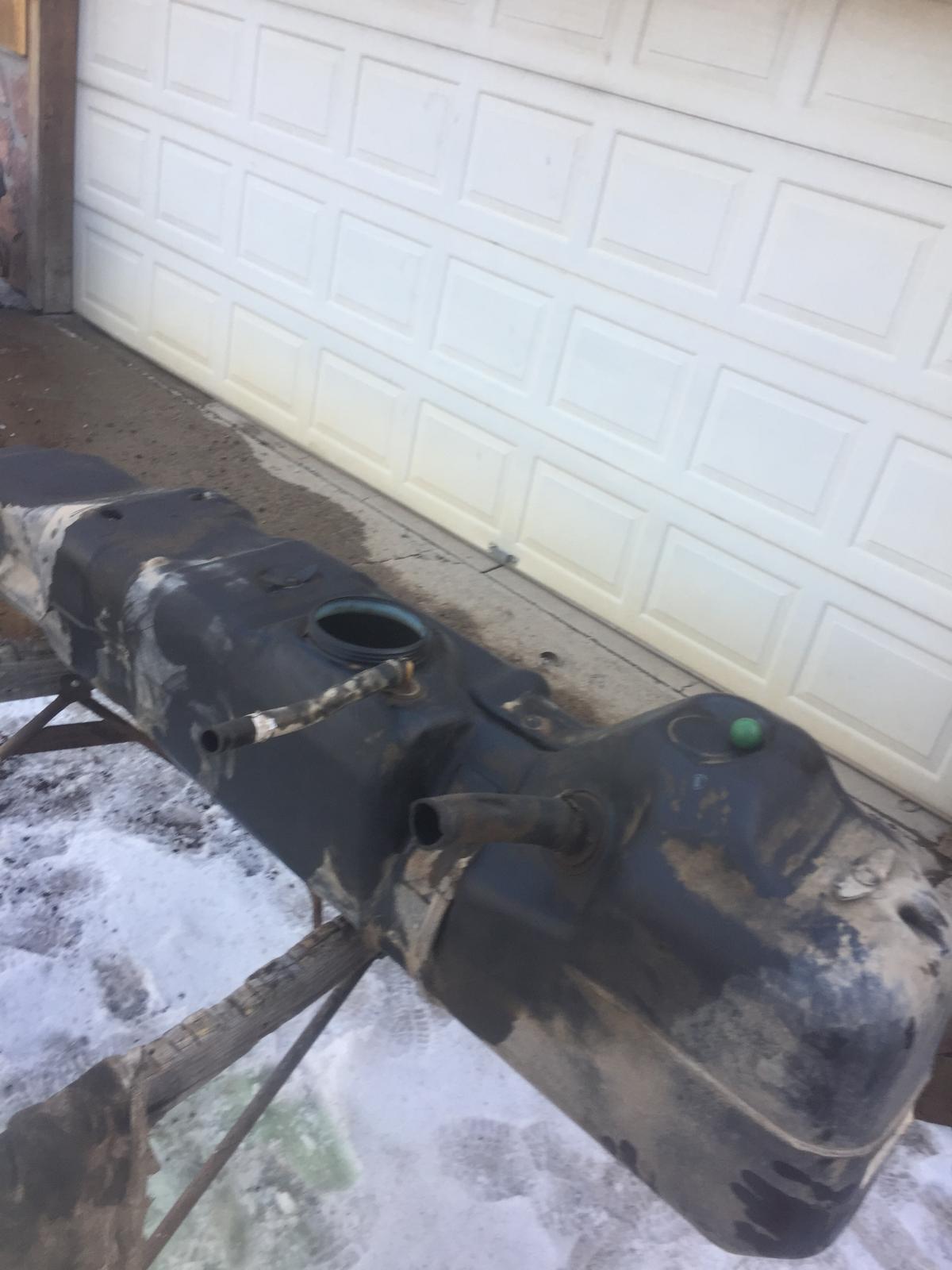

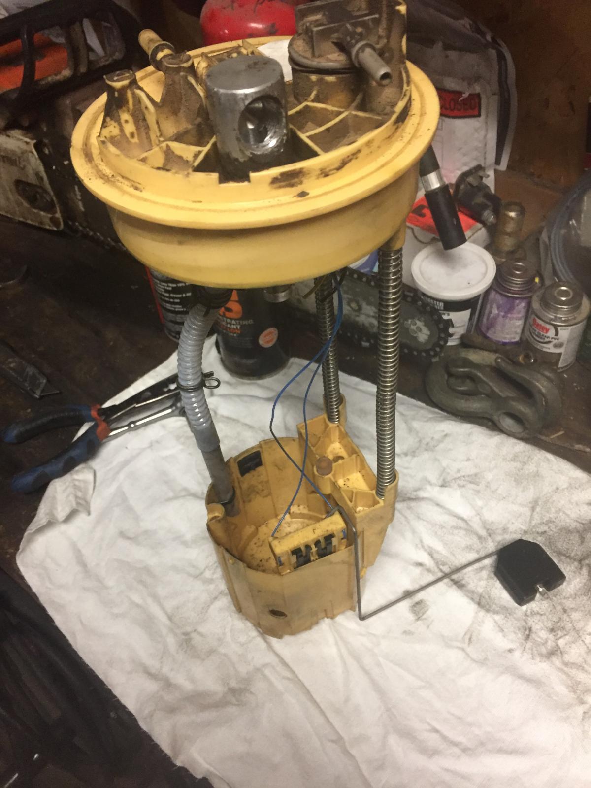

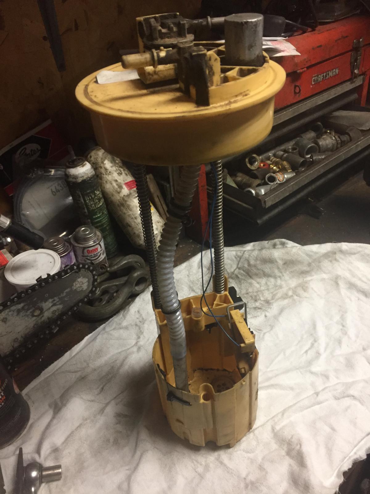

I have the straw installed stand alone out side the basket It’s cut about 1/8” from bottom of empty tank with two notches just to aid in fuel volume suction
Too wide of gap...(possibly) Lay a quarter (coin) on the bottom that what you measure too on an empty tank. No real notches needed I very lightly notch mine, not for volume but to prevent it from sucking flat to the bottom. The design is to let the deflection of the tank bottom rise up to the tip of the straw close to allow it to suck up as much fuel as possible. The bottom deflects another 3/16 or so with the full tank. So cutting the straw short causes the 1/4 tank issue.
