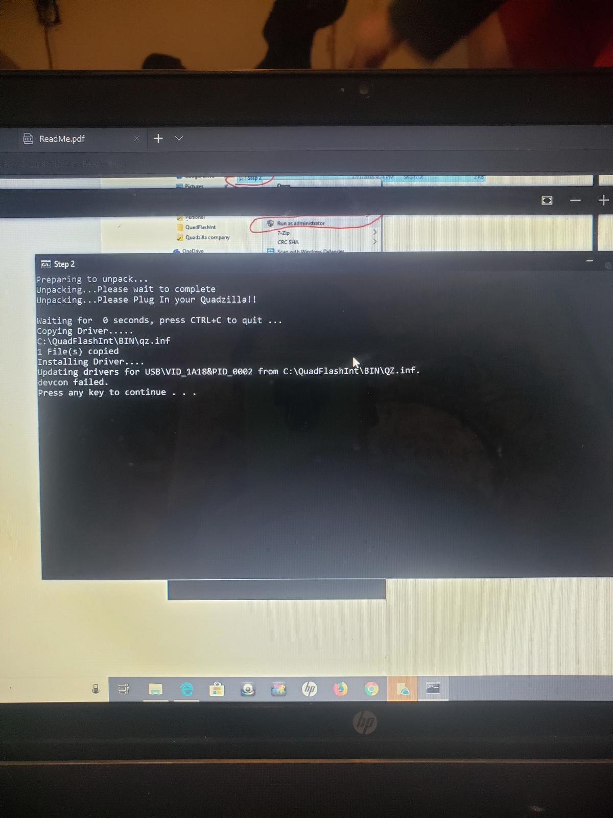

My understanding reading thought the flashing guide, is it is the same software and driver for the XZT or Adrenaline
On 3/1/2019 at 3:51 PM, hdpwipmonkey said:
I have the XZT and used the video in the link that Me posted above and it worked like a charm.  I can flash any tune I want on to it.  Of course I had to go buy an Adrenaline so the XZT is just sitting in the garage now... :whistle:
So your saying it's possible. Interesting. I maybe have to dust off the laptop.
Yep it's possible but I had to follow the video not the PDF.  There are differences between the two and when I followed the PDF it didn't work but when I followed the video it worked. :shrug:
