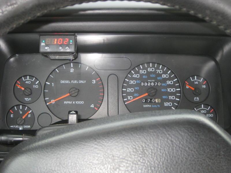

Well I am getting the same results past 400 pretty much, but under 400 it just kinda stopped dropping and when I compare now, the autometer was 50-100F hotter when under that 400, it seemed the colder it was (like when I let off in 5th down that hill and got under 200F) the farther the autometer was off (I think it would have got down to 300-350 on that same hill). Anyhow I got it remounted in an absolutely killer spot. There is just enough room between the black part and the clear gauges thing to get the wires through. You can hardly see the wires since they go straight back. I didn't have to drill out anything.

That is one slick guage install... makes me envious. A few questions, please... What did you attach with? Double sticky? Did you use a mounting box or just mount the unit itself? (Why not? cheaper & less bulk)
I actually drilled 2 tiny holes into the panel right above it so I could run a zip tie around it. I have the zip part above that panel so nobody can see it. Double sticky didn't work because that panel is curved and it just doesn't work at all. There is a 3/8" gap between the panel and the instrument panel clear plastic so I didn't have to drill any holes for wiring.
OK, with magnification I can see the zip tie... still not sure how you threaded it. I'm even more fuzzy about where you ran the wires. Sure looks clean. How about a close up pict? (Sorry about being a PITA)I could see several of those up there rather than a pillar or something.
Your instrument cluster is different than my 01. For starters the guage placement is different. The seam in the plastcs is there, alright. View of my OEM instruments looks like it would be blocked more than in your pictures... I don't know if I could live with that or not. Besides the year of the truck, the height of the driver enters into it too. I think I'm going to make a cardboard mock up & just tape it in place to see what it blocks. Maybe even drive it that way & think on it.Another alturnative... because these digital guages are just 1" H X 2" W... I might consider mounting above the dash right in front on the driver. It might block my view of my hood! but little else. I anticipate needing a visor on it to block reflections on the glass. Really off the wall... I wonder if these could be inset into the edge of the dash bezel, above the instrument cluster. I haven't measured yet... It would take some fine work... but just maybe... I gotta go out to the truck with a cardboard mock up.These are so small, 2 of them could stack in the little dash pocket... I'd have to find somewhere else for my pens. LOL(Can you tell) I'm excited. This may just be the answer to where to put guages in my truck. Russsubscribed
If you really want an idea of how big it is get a pack of cigarettes and there you have it. I don't smoke but I think everyone knows how big a pack is and it is about the same size. The possibilities are endless. Once I pulled it out I was like Woah!, this changes everything! I thought it would be bigger. In direct sunlight it is definitely unreadable unless you can see the tiny variance of red. Being under the dash pretty wall solves that, though mine could use being farther back into the dash.Yeah mine being the 94-97' style does change it a bit. I don't remember what your style looked like around the dash too well.
Thanks for the tip about brightness. I did my cardboard mock up which is why I'm excited... The other possibilities just won't work for me. For the towing I occasionally do, I feel naked without the 4 guage set with the automatic & all... I think this will work.

I really like ISX’s neet install & would like to do so on my 01...I have NO gauges beyond OEM. The Dodge surround for the OEM instruments is a bit different... I’ve been poking & prodding... I can see semi-recessing into the top of the (Second Gen) OEM cluster bezel, so it would be above the tach & speedometer viewed from the driver’s seat.
