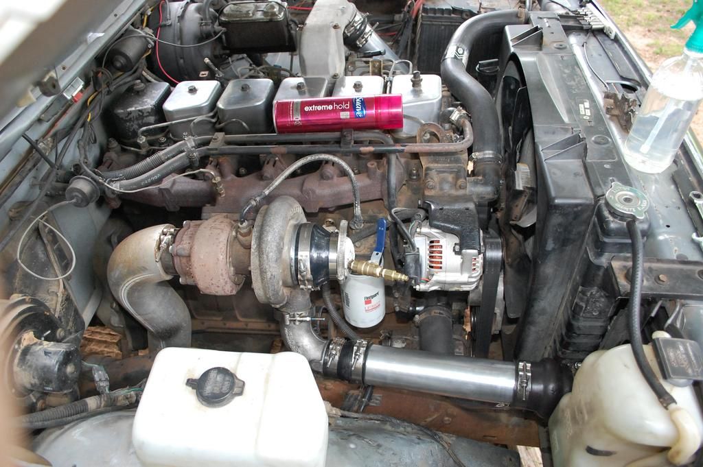

Truck dumped all it's coolant while on the way to work last week, and had to tow it home. Water inlet seal in the block was toast.
While waiting on a seal to show up, I'm doing some "stuff."

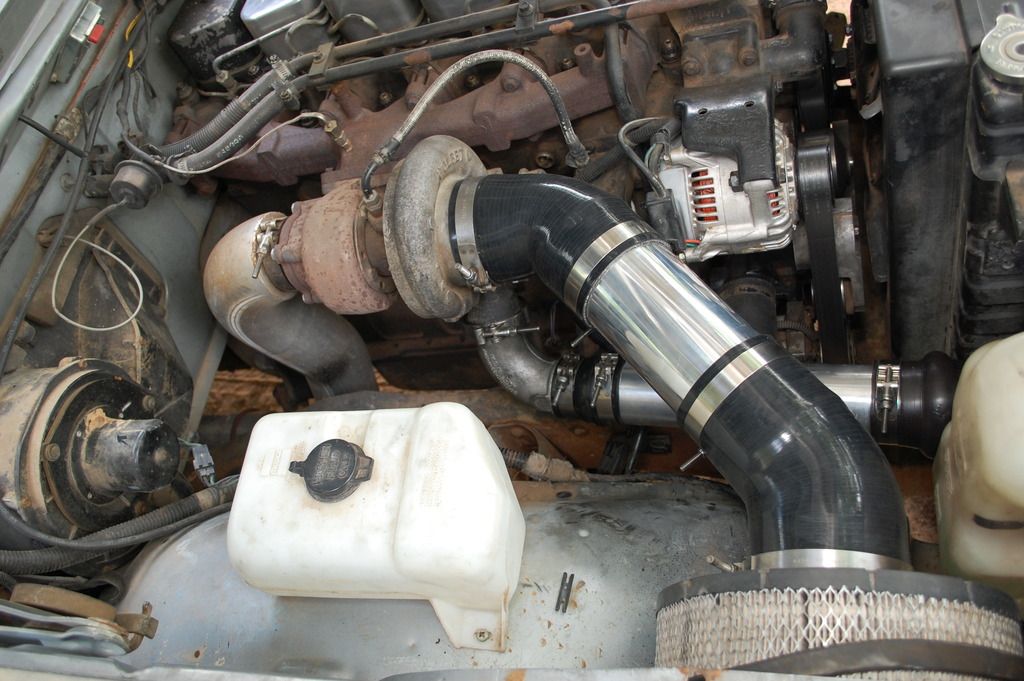

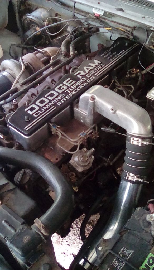

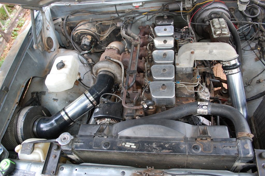

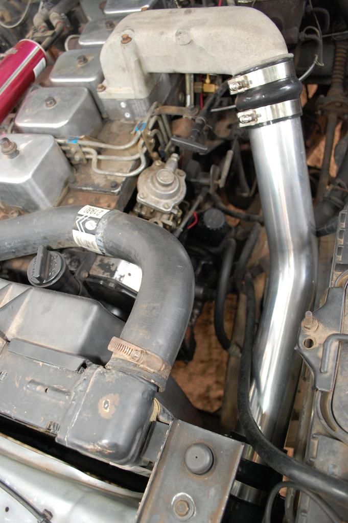

Changing the crank seal, and working on getting a powerstroke intercooler put in, with all new 3" plumbing from the turbo, to a 24V intake horn.

Sometime soon, the intake horn will be as shiny as the pipes...

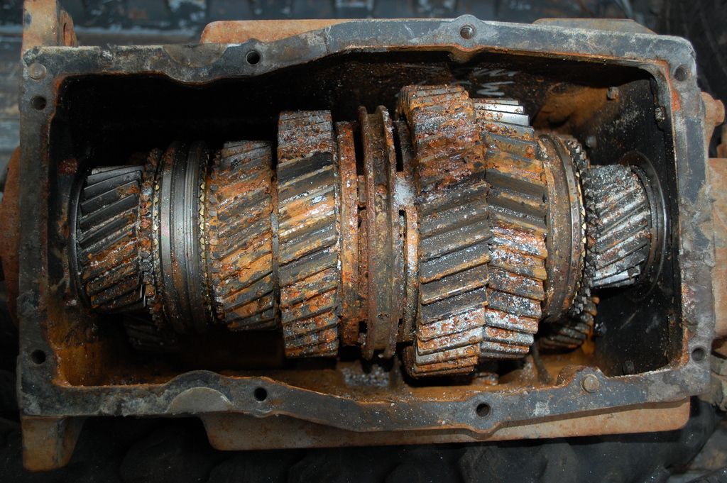

Bought a core Getrag 360 to rebuild.

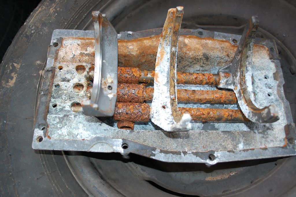

This thing was advertised as a fresh rebuild that has sat for a couple years. I popped the top cover, and....
So I bought it for 200 bucks, and I'm in the process of tearing it apart, and see what all needs replaced. Bearings and synchros obviously, but I'm hopping gears or shafts aren't too pitted.

The transmission was locked up when I got it.
I filled the case up with WMO, and after a week or so, I got it broke free. After spinning it over by hand, it knocked off most of the surface rust, and surprisingly, the gears look pretty good. My fingers are still crossed, and I won't determine if they're usable until I pull them apart and go over them thoroughly.
The shift cover is now submerged in oil. Hopefully it will free up the roll pins and the rails will come out with ease.
This is my first time inside any kind of transmission, so it will definitely be a learning experience.

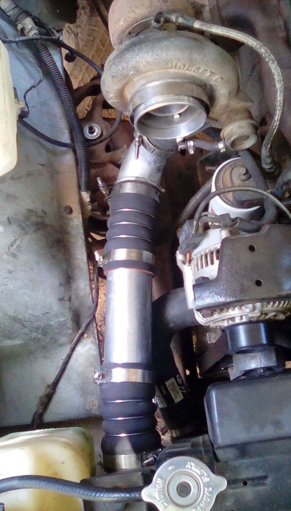

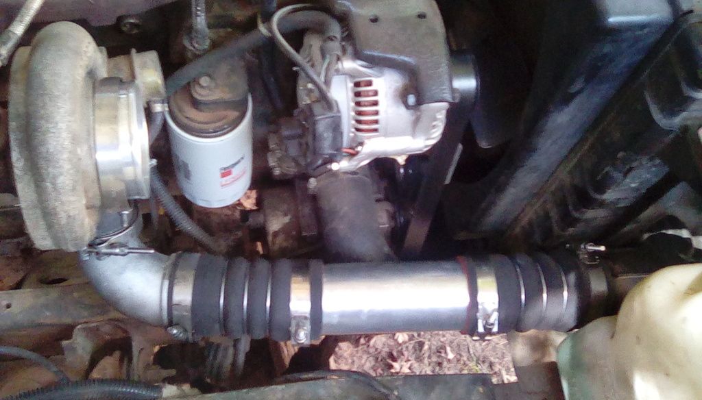

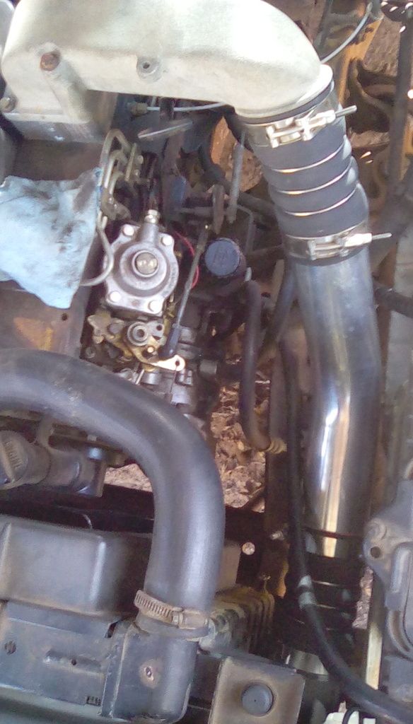

And I got tired of blowing the 2.5"-3" coupler on the charge pipe coming from the turbo, and not having much faith in the other intercooler boots, so I upgraded to a 3" outlet off of the volute, and better 3"x6" boots.
I squeezed 38 PSI out of the HX35. Now I need some constant torque clamps.
