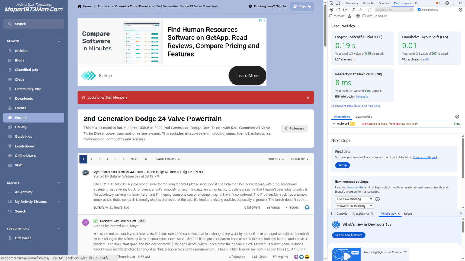

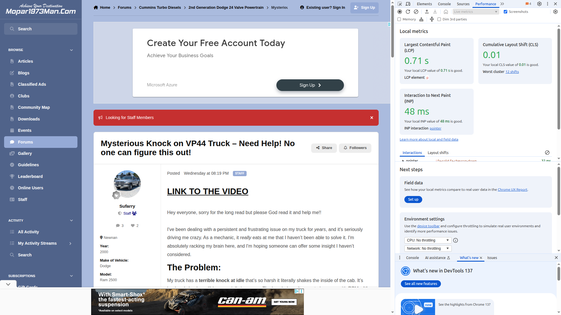

The results of the code change below. The Google side panel is on the right showing the CLS value of a few random pages.
