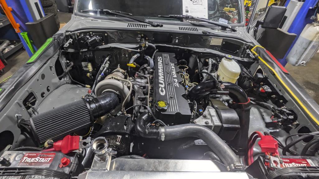

  1. Found out it was a harness issue. Company shipped out another and all running accordingly. https://studio.youtube.com/video/mVtn8sBoItM/edit Thanks @Mopar1973Man for the call and chat. Cheers buddy! Jason TT

  3. TRAIL TAILOR started following 24 Valve Swap
