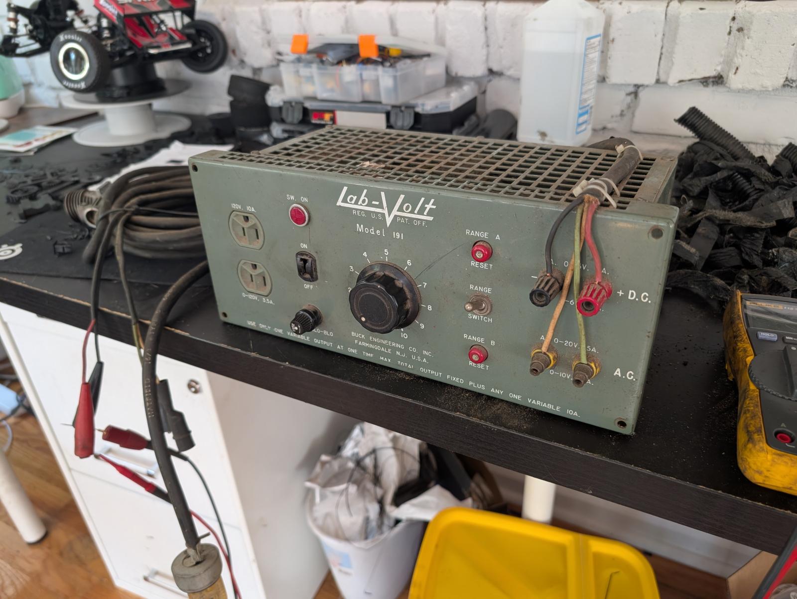

So far I have found nothing! It's not difficult, just time consuming. I have this old power supply that I'm using to help load test the wires! Good to know! Im a cheap *** and prefer to struggle my way through this LOL.

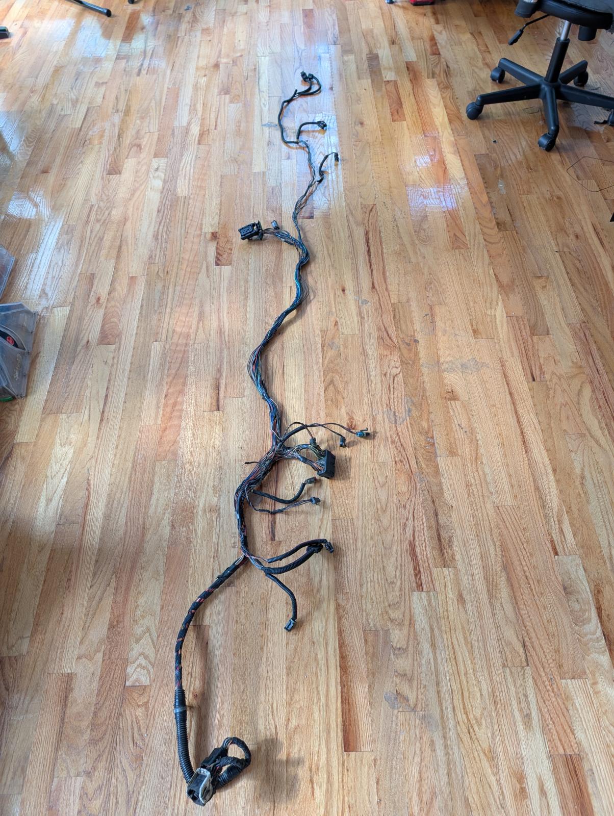

Well, I decided to pull the engine harness. I want to completely strip it down and go through EVERY wire just to eliminate the possibility of it being a harness issue... The amount of man hours I have into this issue is actually insane.
