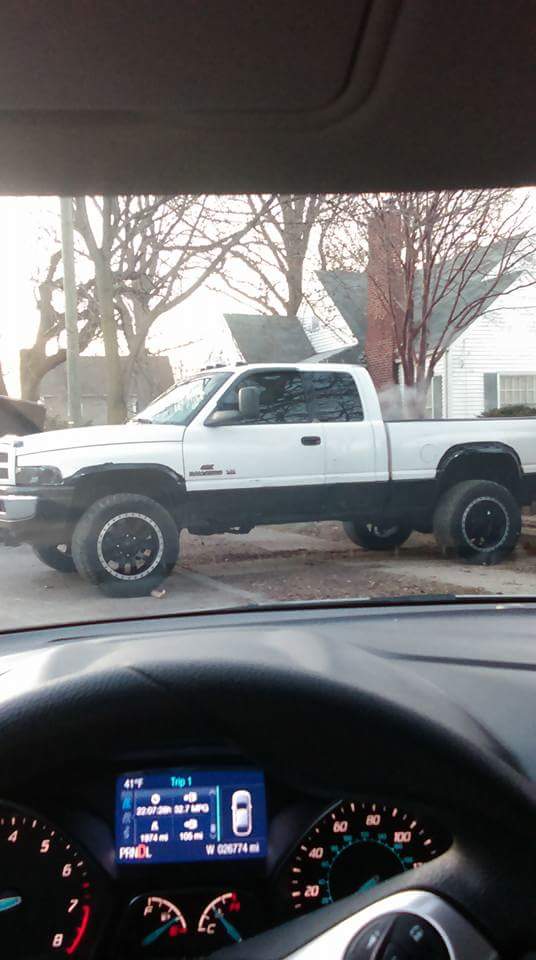

  3. That what i thought too but ive done the carb spray to see if there was any leak around the throttle body or surrounding area snd nothing also the scan has only came up for the 02 senors which ive replace
