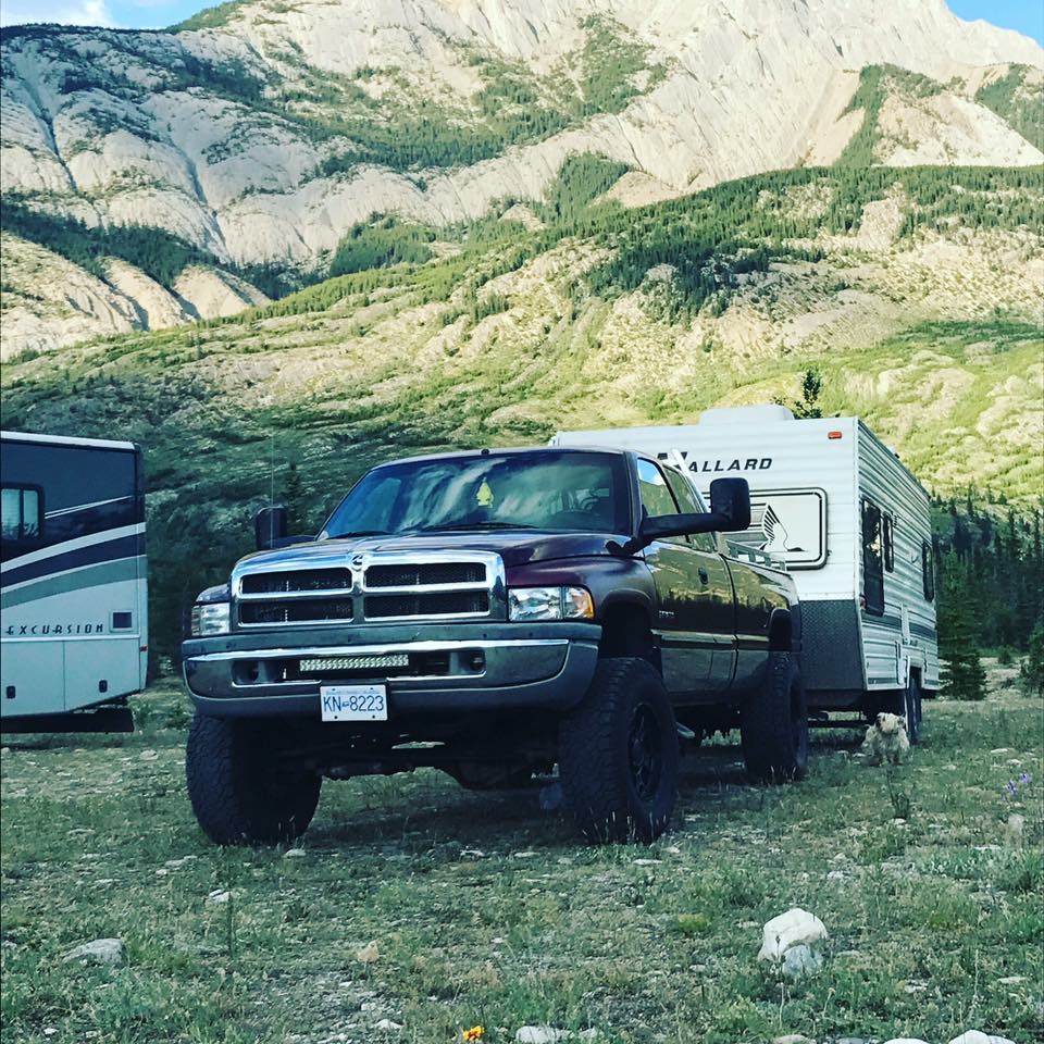

  1. Thanks man I actually just had to remove those to start hauling a fifth wheel trailer I bought
