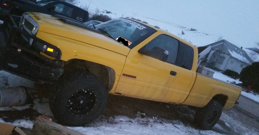

  1. Yes. I ordered mine off Ebay. For mine i typed in 98 ram 2500 tow mirrors and scrolled until i found the heated power, etc. They were plug and play perfect. Then to hook up my blinker on them I just tapped into the front blinkers.
  2. I have a 98 12 valve that I have installed Ebay 4th gen dodge tow mirros on. Perfect fit. Mine have power and blinkers. To write the blinkers, simply cut the 2 prong connector off, using a crimp eyelet on the black wire, scratch a bare metal spot on thedoor near plug and self tapper it securely. For the red positive wire, splice approximately 4feet to it, run through fender front headlight assembly and tap it into the solid color positive wire. (No stripe) do this for both sides and they will flash with factory blinkers. !!!!!
