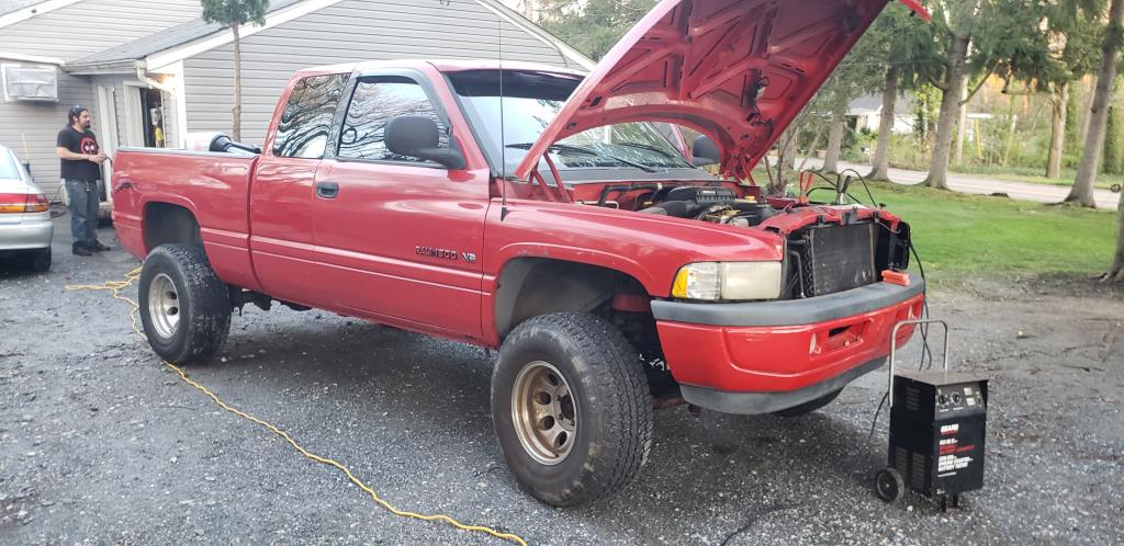

  1. Jess L. changed their profile photo
