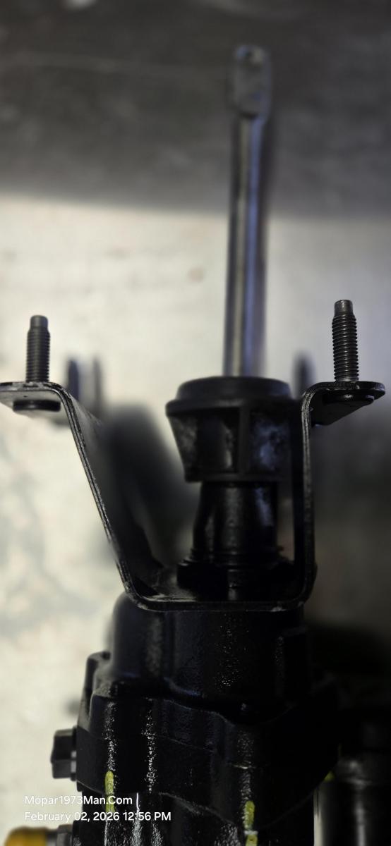

Rubber boot that goes on the input rod.

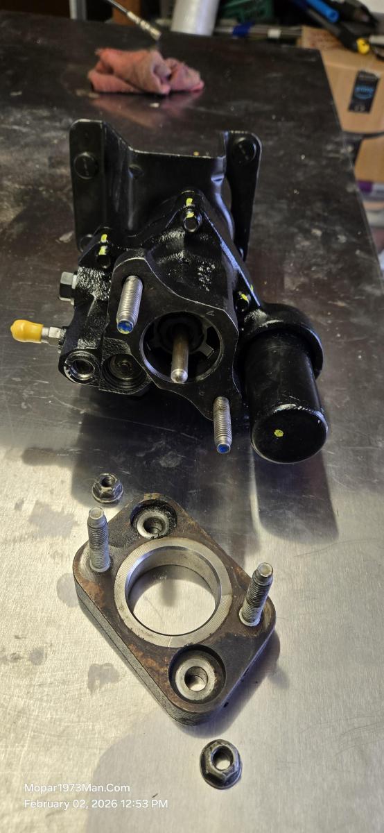

The master cylinder adapter so the master cylinder will mount!

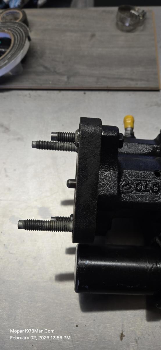

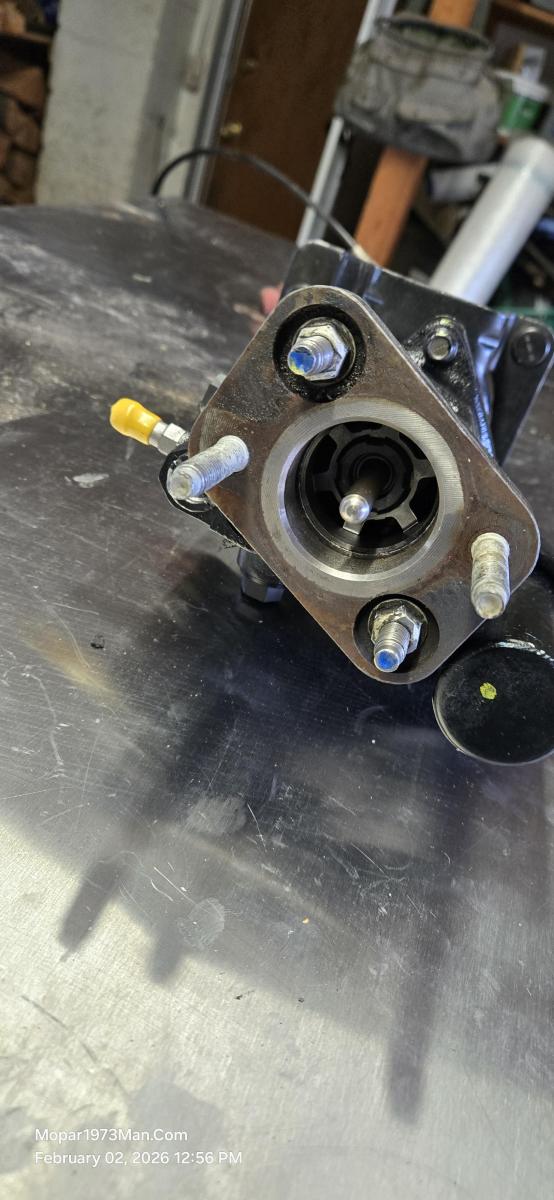

Adapter all on and tight. As for changing the rod that is done by flipping the armed washer like a freeze plug and then work the two arms out of the groove. WARNING: Flying part hazard. The armed washer and the spring will fly so be careful and aware!
