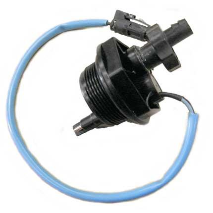

Note the water in fuel sensor / drain.  this sensor can be unplugged from the truck harness to make removal easier.
The Part number for this is PFRK54553  but you dont need to replace unless damaged.  a new o-ring comes with the filter.
