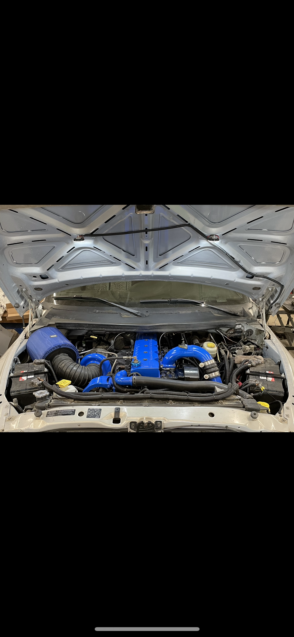

  7. LTL Diesel changed their profile photo
