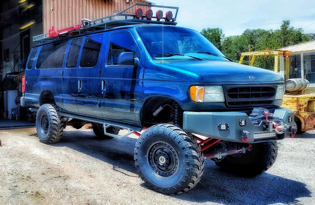

  2. I have just build a 2006 Ford E 350 van with a 24 valve cummins / Allison trans and a 4x4 conversion. I got the engine from an auctioned truck (2001) on the title. Have it running and driving but in limp mode so far. Cam sensor code, After alot of messing around I called cummins and they told me the engine number and ecm p/n are for 1999 but my harness wiring colors tell me it is off the 2001. I have both diagrams printed out and seen the number 9 pin was empty and should be for the cam signal on a 99 so I got a pin from cummins installed it tagged into the grounds and 5 v with a new pig tail and hooked cam and crank up as I think it is meant to be but still throw cam codes. I am spinning my wheels what to do next!
