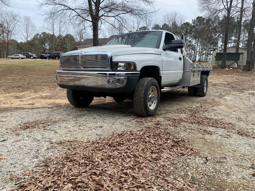

  1. So, picked up a 1983 Suburban 3/4ton 2wd, only 47k original miles, but been sitting for 25 years. Has a little surface rust on the top of one fender, and only other rust is in the rockers. My neighbor sold it to me, and also has a great running 1992 first gen 5 speed 4wd dodge that is about to get a p pump 24v swap, so he said I can have the engine/trans/radiator, ect... I guess the fun is about to start, I'm sure I'll have some questions along the way, but I'm excited about this project. Don't mind the tire on the front, had to pull it here and she doesn't have brakes....
