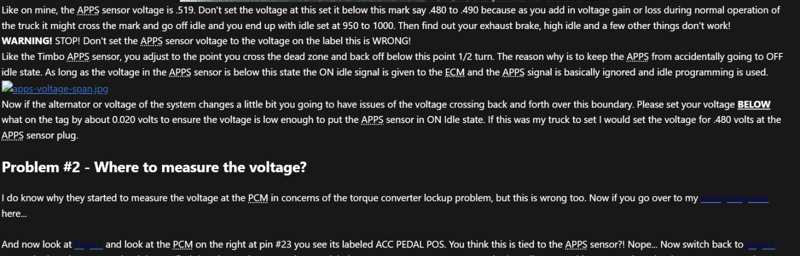

  7. Hello @Tractormanthank you very much OEM APPS for the ford 7.3 or 5.9 Cummins ? Timbo's APPS could solve all my problems. Patch

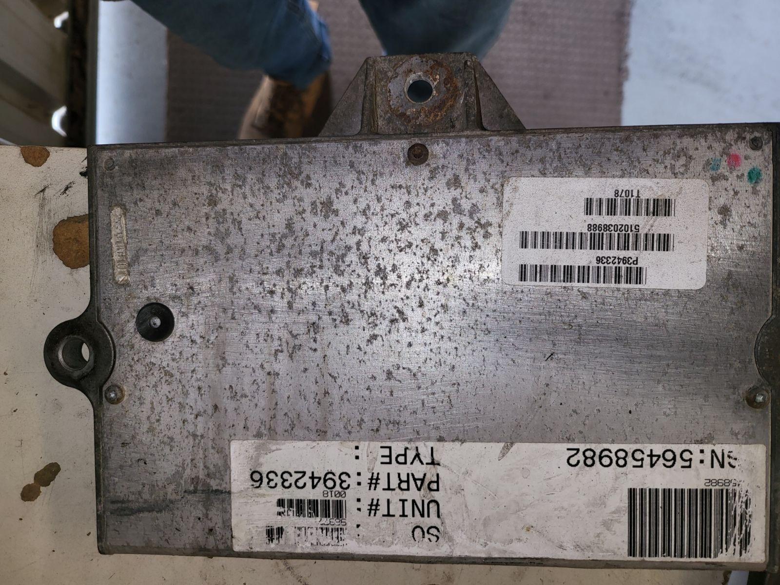

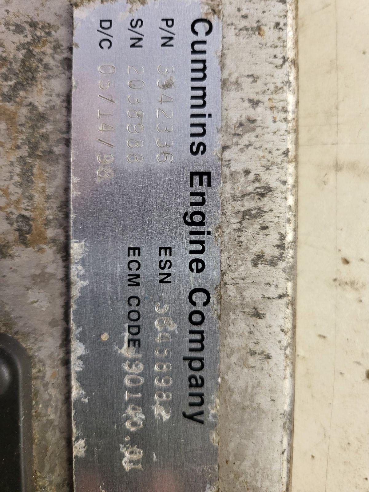

  8. Hello @Tractorman I wasn’t the one that carried out the conversion. This is my current APPS sensor

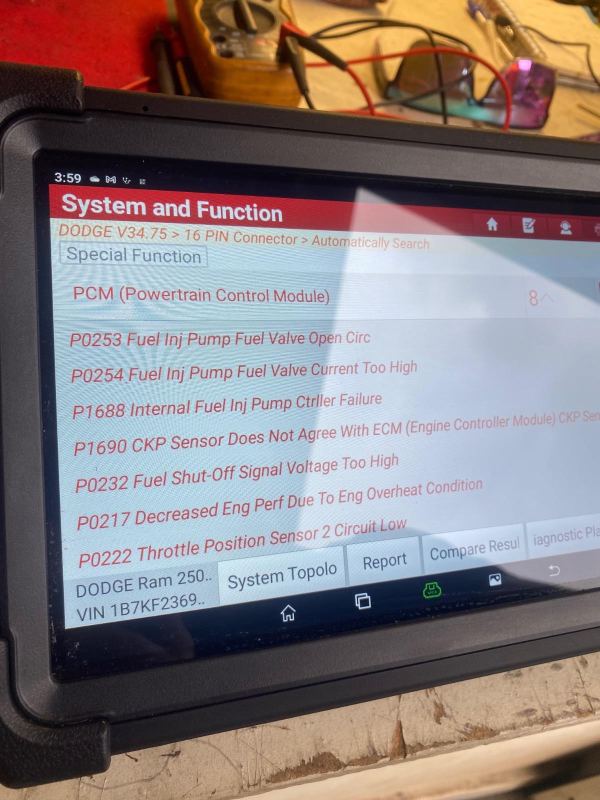

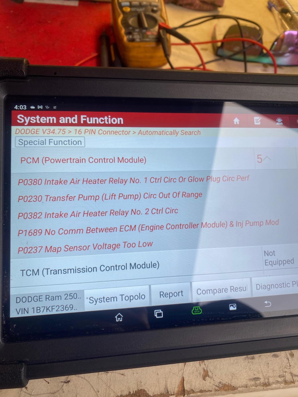

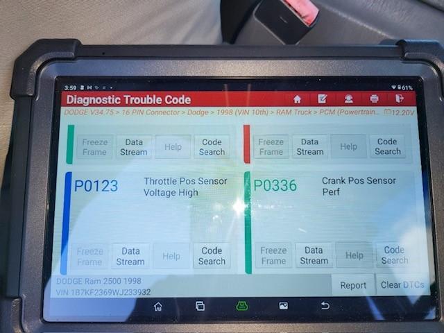

  9. Hello @Tractorman where is the idle validation switch Also where is this Miss or buck This usually only happens on really old versions of our FMS boxes and can be diagnosed by shaking the box in your hand and if you hear a rattle, then it PROBABLY has melted the power resistors off of the circuit board. This can be repaired and upgraded to the newer style for about $65.00, plus return UPS shipping. Please call for unique address for where to send it for repair.
