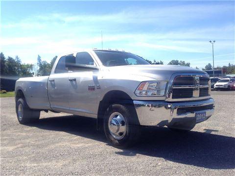

  9. @Me78569, Thanks for the interest in this issue, i have the same truck but non HO and a 2000 reg cab with the same edge setup, and have never seen anything to do with boost codes, so ill look into that right away.I havent checked the grids yet as i will just swap the out with my 2000 and see what changes there ( i dont have much for electronic testing equipment) as for the speedo, it works when the abs module is plugged in but not when unplugged and i rarely spin the tires but it does happen when i sneak onto the highway in a hurry (45lbs gets her excited) I would assume the edge has its own voltmeter seeing as how it has a positive and negative terminal to the battery. I hope it isnt the ECM haha but if thats the case i will take some time without a speedo and start saving @Hawkez that will be my next step im thinking, also i could be wrong here but i always assumed that they are vin locked? Also i just remember the other day i msg'd the old owner to see if he ever ran a boost fooler other than edge and he said yes, but it fried the ecm ( leads me to belive it is a new one)
