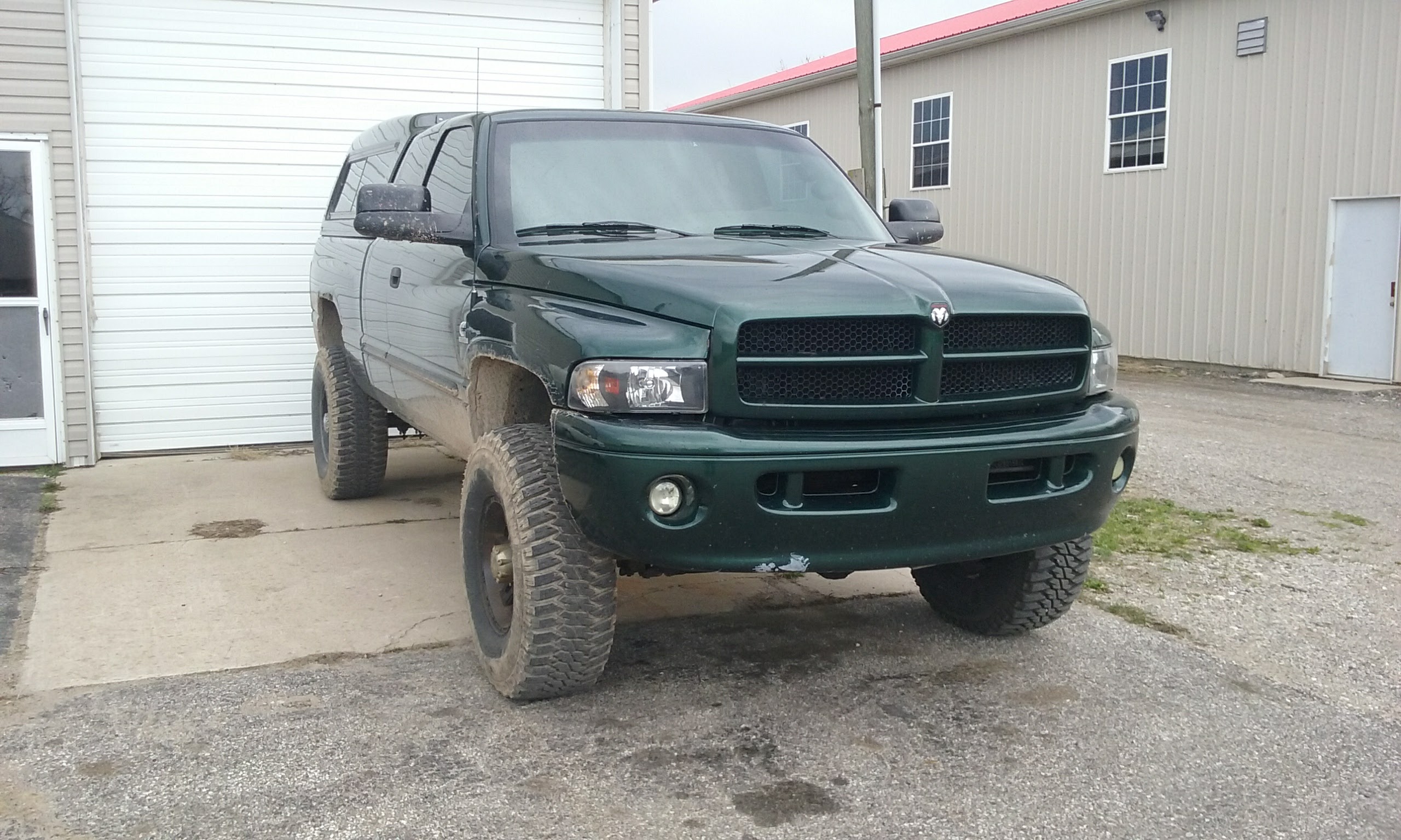

  1. Not sure of the fuel pressure... Haven't went down that rabbit hole yet... Has a newer hot rod vp44... when i first put the el cheapo apps sensor on and calibrated it the truck ran great. Throttle response was great. Only have the one p0222 tps code now. And throttle issue is back...Not sure what brand i got its not a cheapo like the last...the ccd is still on the overhead but im not sure if its on because my mirror fell off... Next to a new power wagon... Both on 35s Im sick of driving my vw diesel i havent had to by diesel in 2 weeks... I want the beast back in action...
