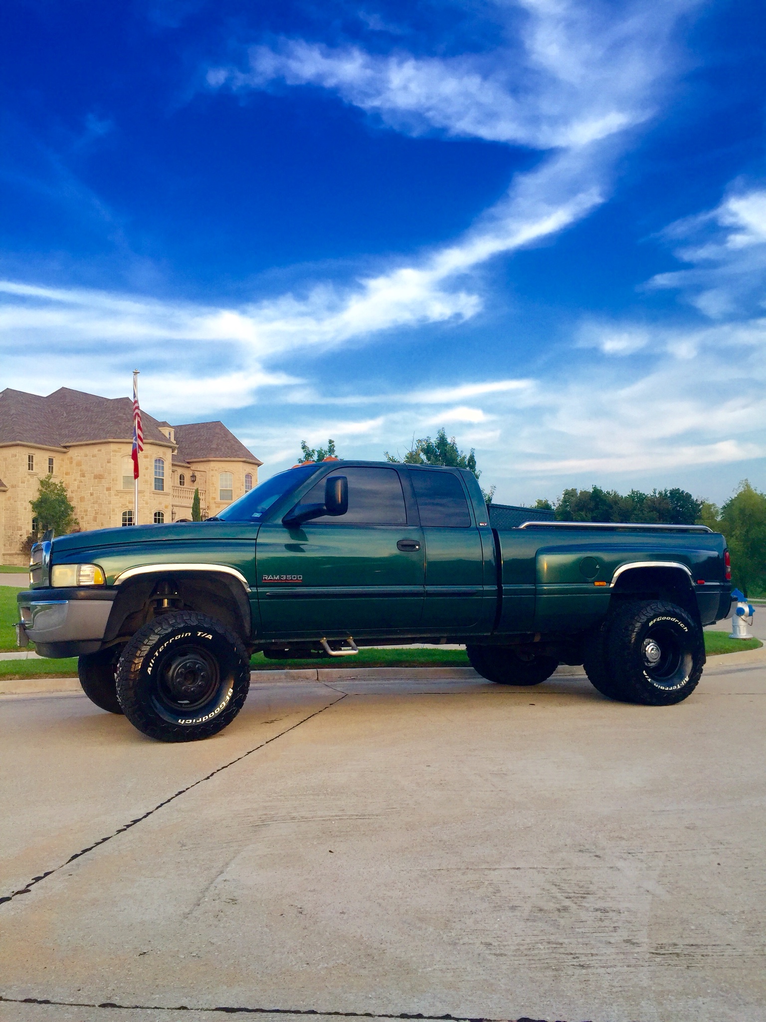

  6. So I have a 2002 5.9 dodge 3500 SLT automatic. Not the best turbo but I wan’t to get the most out of it. I have an iQuad v2 tuner with 10levels plus a boost fooler. Never go above level 5 due too stock transmission. Id say I have lightly modified it. Larger exhaust minifold, 5inch turbo back, 275 RV injectors, Airdog ll 4G 165, AFE intake. I have gauges on everything to monitor. The most I can get is 23pds of boost. I have heard some guys tighten something to where the waste gate stays open. Is that do able on my turbo or would anybody even recommended it. It would be cool to see like 30-32pds of boost but I know at the same time it’s not going to be any better on a stock tranny. Just want to know if it possible to do, if so how and would anybody recommend it?
