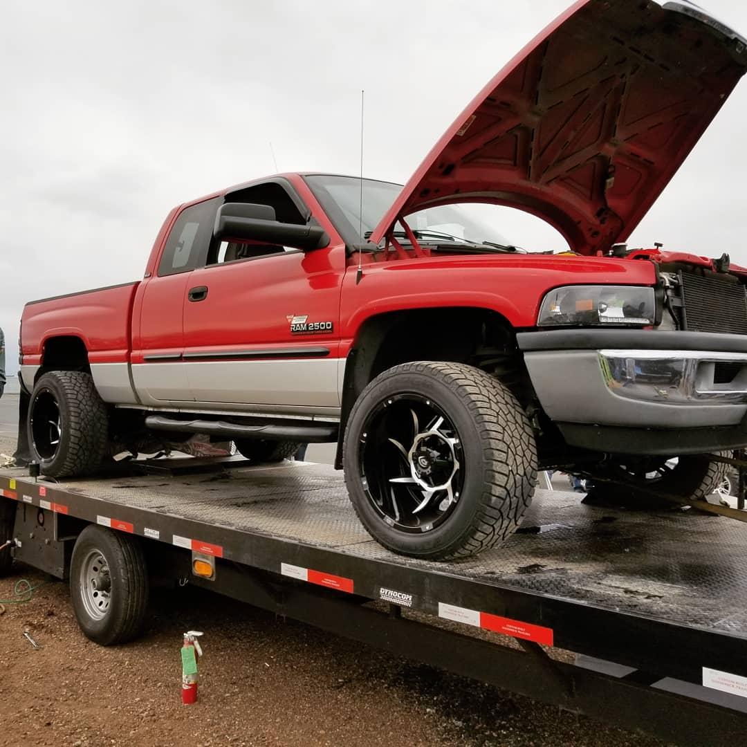

  1. Ok long delay in posting, but made some decent headway in figuring the tuning out, I think. I will attach the tune I am running currently that also happened to be the tune with which I put down 655hp/1240tq at a local drag/dyno day on May 18th. The dyno seemed to be reading a bit low (30-40hp/100-150tq) based on a number of rigs with very well known setups that ran that day comparing to what trucks with same/similar builds are normally putting down. Possibly due to the higher altitude of the track, dyno not loading as well, etc. The high power trucks that had been dynoed multiple times before were relatively close to expected power on this dyno, albeit a bit low, so I assume my numbers were not a fluke. Most runs, including mine, were run in overdrive (6th, in my case) to help load the truck more effectively. The smoke output of my truck even at the top end was IMMENSE, suggesting I may be able to push the numbers even higher with more air and/or nitrous. I probably would've fogged the truck if I had a clutch that could've handled it, but somehow the 500hp ebay single ceramic clutch, fass 95G, and 380k engine/HO pump still allowed the truck to make well over 100hp above my expectations. I will pull the CANBus fueling down and extend the ramp out to cut some smoke for daily use on this tune, but surprisingly, as long as I am somewhat easy with it, the truck is actually LESS smoky with this CANBus curve that starts at 100%, especially on light acceleration, than with my previous curve that started down at 68% @ 0psi. It drives much smoother as well, and feels noticeably quicker/more responsive in general with less smoke, and boost pressure is easily HALF that of the previous tune at any given point for the same perceived acceleration rate when driving normally (i.e.: average daily driving acceleration would produce ~10-15 psi boost, now 5-7 psi for the same and even quicker acceleration). The main thing between this tune and previous tune was the CANBus curve, with only minor timing adjustments if any, so I guess I could attribute the power/response increase to better atomization with a longer injection pulse? If anyone sees any glaring issues or places for improvement on this tune, especially in the timing department, I definitely am all ears and will test/datalog/respond with my findings. I wrote this tune for the dyno run and maxed CANBus command quickly, but I think it's too much fuel for the turbo on the bottom end because anything past 1/3 throttle from no boost actually spools the turbo slower than when rolling into it. It's also too smoky for the street past half throttle with no pump tap and does not clean up AT ALL even at 45psi, EGT's @ 1500+ on a hard pull, CANBus fuel only. NEED MORE AIR First two dyno pulls were with the previous "street" tune that ended up at about 105% CANBus at 30+psi on the max tune level with fuel stretch at 1800ms and did 508/1080, but the dyno software had a hiccup and didn't record either of those runs. The last three were done with the below tune (albeit with pump tap starting at 25% and not 0%) at maximum tune level again with fuel stretch at 1800 ms. Only difference was maxing CANBus fueling command at around 138%. Last two runs I tried loading the truck at different RPMs, but didn't have much luck and everything was already heat soaked after the first two runs and getting progressively worse I'm sure (no fan in front of the truck). Pulls were done to around 3200 rpm when I felt the power nosing over, and the graphs suggested max power was made between 2700-2900 with over 500 available right when the turbo hit all the way to redline, torque hit max pretty much instantly down around 2200 and over 1000 at end of run. The dyno was on roll speed calc, so wheel speed and not rpm based, but just guessing based on when I started and ended the run (~2000-3200). 20190518_154727 race tune pull 1 highest power 655hp 1240tq TRIMMED.mp4 iQuad-Race-2019-05-30-02.03.568228413070918849844.json
