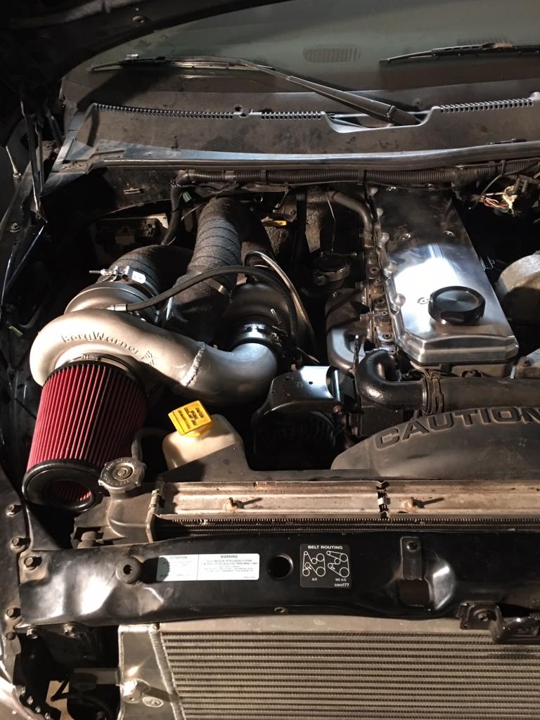

  6. I’ve just got the truck running and still have the edge comp box installed and it is a smoky mess so I’m looking to get a daily tune that I can work off of. The mods to the truck are a 6.7 188/220cam 6x.018 injectors dragon flow pump and sxe480 and a sxe364.5
  7. I did not go with the 4K just because of the drivability. Correct me if I’m wrong, I can always switch to 4K but once I have it I can’t go back without a board change
