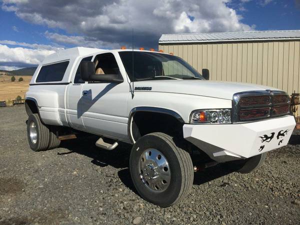

  2. 1998.5 Dodge 3500 4.10 axle dually 19.5 Eagle alloy wheels with new custom steel inner rims, bead balanced tires. new drivelines trans. mount, rebuilt NV4500, DNE od. 3" leveling front 2" blocks rear. vibration in rear noticeable around 55 mph - 70 mph. enough to shake the mirrors, bed welds cracking at rear, and jingle anything in door pockets. I have visited several forums with same issue but never heard of a resolve for this. This is NOT FRONT END, TIRE, OR DRIVE LINE ISSUE. Seems like every time I read about someone having this exact same problem there are dozens of helpful people pointing at everything but the actual problem. I can take my hands off the wheel at 100 and it tracks true, I just cant drive at 100 all the time. It feels like oscillation or out of balance in rear tires, but that's not the problem. I have changed the tires, wheels balanced and re-balanced and nothing changes. I am thinking something in the rear end but cant pinpoint it. No leaks, good brakes, Bosch drums proper oil and LS additive. There must be someone that has actually figured out what this problem is. I have searched many forums about people with the same issue only to watch it turn into a hijacked discussion about what to do about a death wobble. Any actual experience with this would be helpful.

  8. I have a 1998 3500 4X4 dually 24 valve fresh rebuild (3k miles) Industrial injection Hot Rod 44, Hamilton springs, 120 BD sticks, Air dog 150, Quadzilla , 5" exh. , Packbrake, DNE2 OD, NV4500, SB DD clutch, S&B intake & filter. Just installed Custom Airwerks turbo close to Silver Bullet in specs. Loaded trailer went from Boise to Portland and back and towed great. Only issue I had was too much black smoke for my liking at low end. by the time i got back the smoke was getting worse. Went through my injectors but no change ( easy to make all traffic vanish in my rear view mirror with pretty light to medium throttle . Decided that maybe turbo seals were leaking as adjusting tuner doesnt seem to do anything. Put stock turbo back on until I could get the new seal kit installed, which I did Monday after work. When I tried to start the truck I didnt hear the fuel pump cycle so I went to check my work and noticed that I had pulled the Negitive wires from the Batt. terminal Pass. side. Reinstalled cleaned tightened all terminals. No fuel pump no gauges no screen on my Quadzilla. (pv2) Pump is good Did the odometer check with key and got 900 920 921 940 950 999 codes, let it gauge test and all gauges moved through proper ranges. All dummy lights come on and she cranks. There is one odd thing I noticed. when the key is off the WTS light comes on faintly . turn ign. on and light goes out. I can make the light clear by removing battery cables or ECM plug. Turn ignition switch on light will return until power is removed again. Maybe PCM or injection pump? I dont think it is the ECM, but I put my spare ECM on and with key pump comes on but will not stop until power is removed and WTS light and no gauges still th same. I hate these wtf just happened issues.
