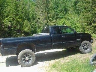

  1. No insight yet. I ran the truck today and wow. 1/8 tank to go 20 miles. At 70mph I'm at 1000 degrees egt and at idle it wont stop smoking. Black smoke at 400 degrees egt. 180 engine temp. 15psi fuel pressure at 70mph. Wtf. New ip and lp and over flow banjo. Before the lp failed I can go 450 500 miles on a tank. Anybody have a clue?

  7. Yes. I bought the truck and it ran perfectly. No issue at all no codes. Now it runs high egt at Cruze throws a code and drinks fuel like mad. I can't read the code with my super chip It will read and say no dtc. But it wont let me go back to stock. It says can't communicate with ecm.
  8. Yes fuel system is all stock. Truck ran fine before VP failed. So I did the normal new ip New lP new filter.I was getting 30+psi boost. 13psi is wot under load at 80mph. It's a 3500. Weighs 9600 with my tools in it. Haven't pulled a trailer yet. New fuel system and then this all happens. I tried to pull the chip but it wont communicate with ecm. I want it stock so I can start my own build. Apps is parts store. It runs strong till the cel comes on then defuels. You can wait a second and then it runs iffy.
