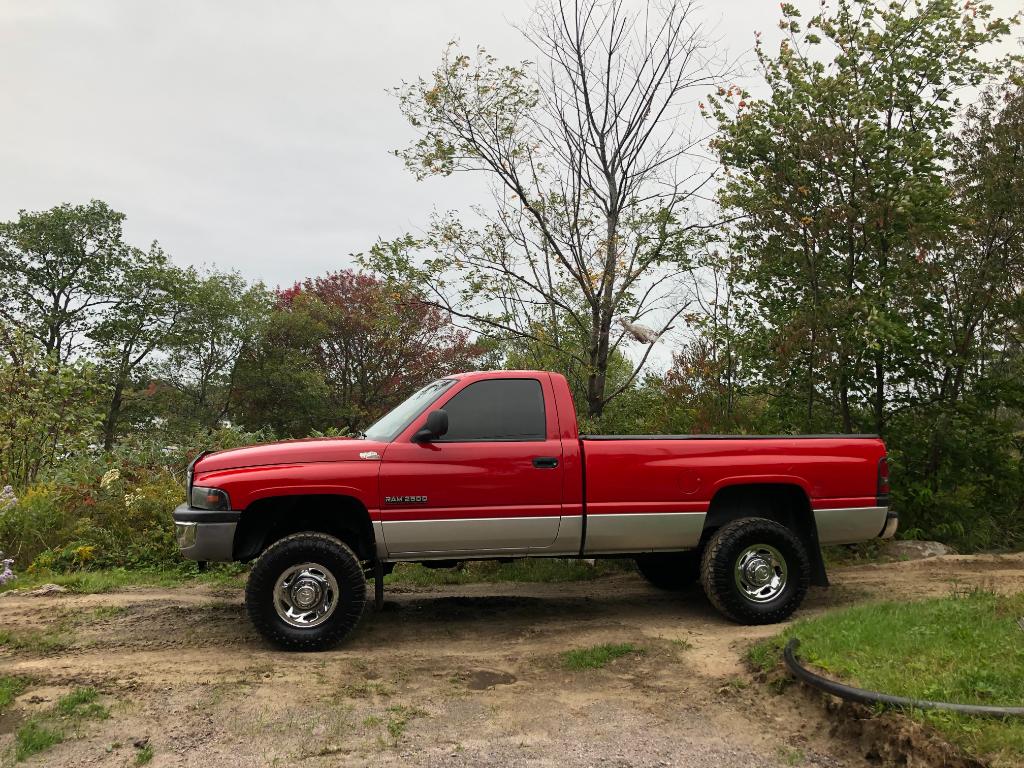

  4. Joshschneids changed their profile photo
