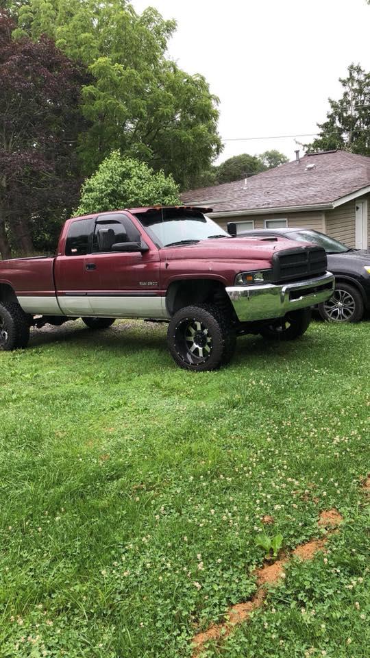

  3. ok guys any advice and idea new to the forum I have a 2001 2500 5.9 trans started slipping I found a used one for a good price and purchased it only had 15,000 on rebuild it was out of a 99 installed and had no o/d or lockup unless I used the l/u switch still no o/d replaced the governor pressure solenoid and sensor without any luck I'm getting ready to replace to o/d solenoid so I have to drop the valve body and ideas of advice is greatly appreciated this is all my first experience with transmissions
