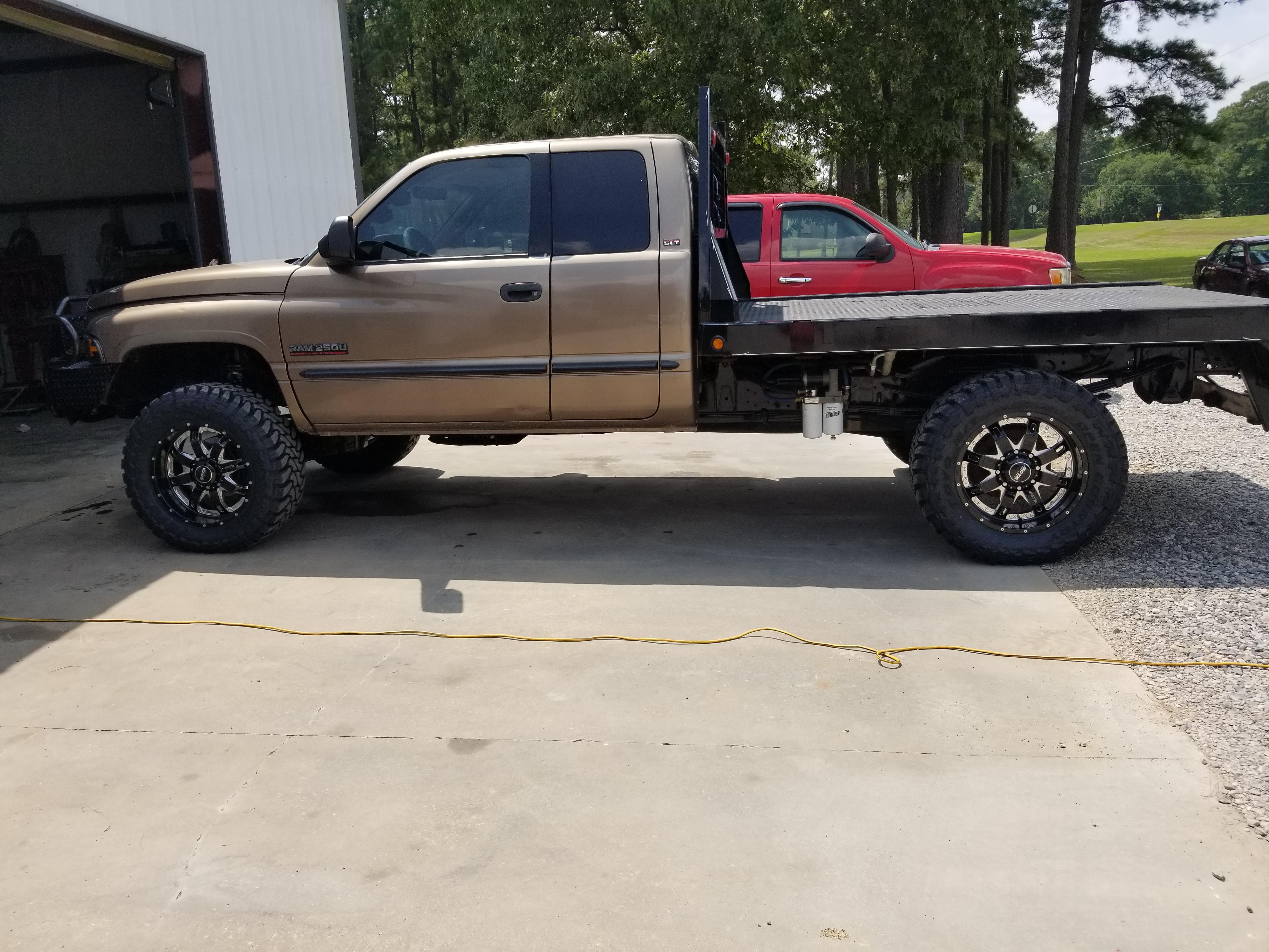

  2. New member to the forums fellas but I have been quietly reading for a few years. I'll start out with what I have. I have a 01 24v 6 speed. She has quadzilla adrenaline 4k, intake, intake horn, exhaust, necessary gauges, fass 165, and studs. Also has 190k miles A few months ago my pedal would just go dead and after contacting a few local guys and reading I decided it was TPS. Well now that I replaced it with a new one when i set the quadzilla to level 10 at around 2500 rpm she begins to shudder terribly until I either floor it or let off. It never this to me until I replaced the TPS. When i drop it to stock on the tune there is no shudder. Fuel psi stays constant 15psi. Kinda lost is it the TPS or possibly the vp or just the tuning now that the sensor is new?? Thabks for any help
