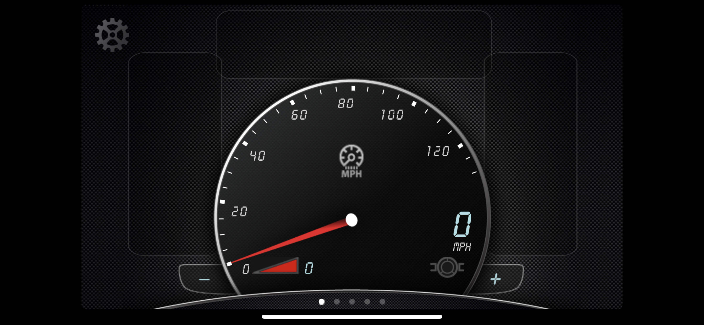

  7. Thank you! I can read diagrams somewhat well, just to confirm I’d be checking the ohm reading on the data link to injection pump or #23 on the ecm? I attached a pic of what the iquad was stating after the first start up after install. Just got off dad duty so getting in the garage now! I initially purchased the quadzilla due to all your write ups and available tunes for purchase, once I get the truck squared away I will reinstall the quadzilla and purchase a few times and also make a few of my own. Thank you man. Also I’m running into a wall when trying to complete my profile?
