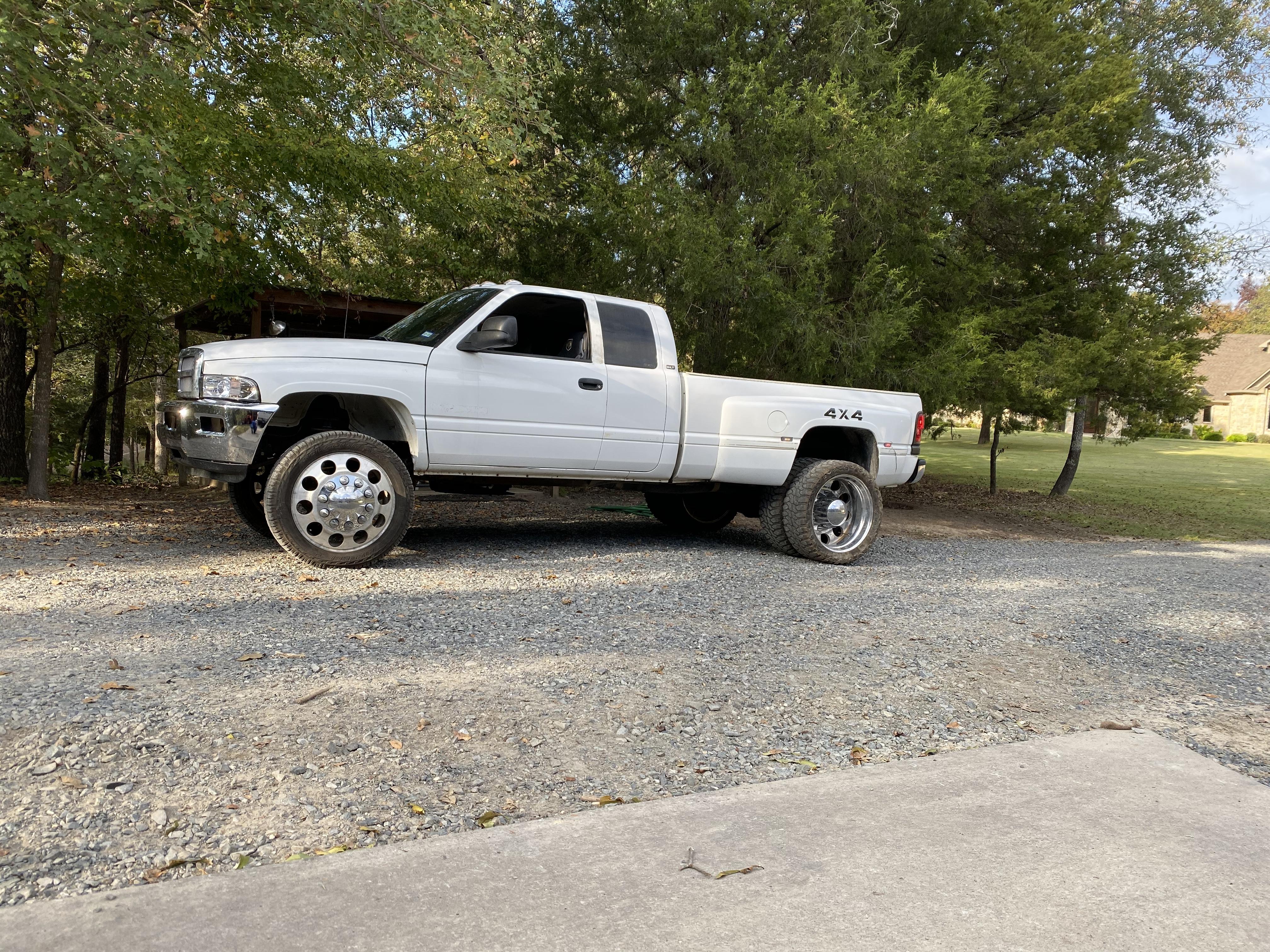

  9. I’m running the stock tune that came on the quad and I just turned it to level 7. ’m running the stock tune that came on the quad and I just turned it to level 7.
