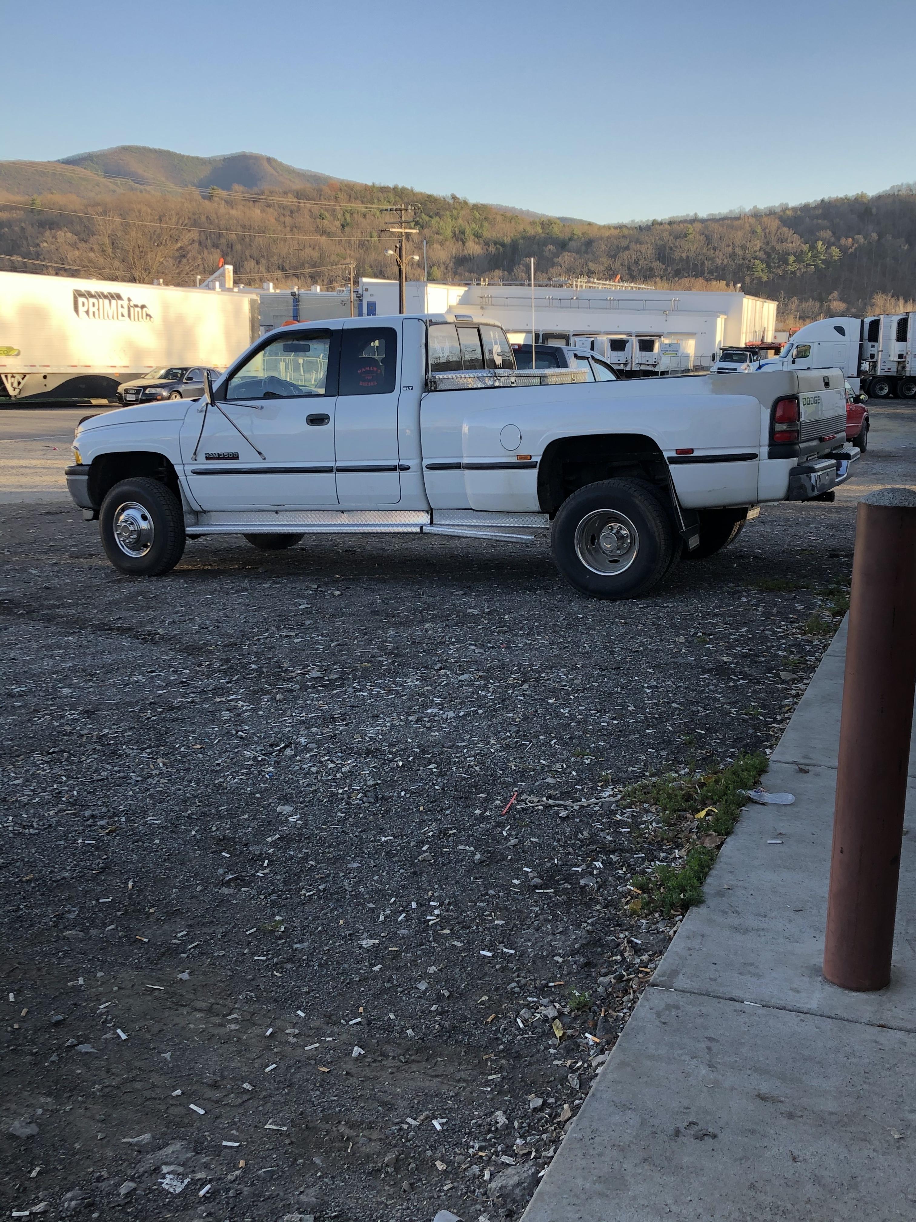

  4. New here so haven’t read all the posts yet. I have a 1999 Dodge 3500 5.9 Cummins 24 valve. Truck sat for 12 years after my dads death. Been working on it for the last 6 months. New VP44, lift pump, fuel filter and so on. New turbo, APPS, all sensors and so on. My issue now is I can drive the truck as long and far as I want to, no issues, no power loss. As soon as I shut it off and I re start it after being off for 15 mins up to two hrs, it will run for five mins or so and just shut off. Won’t restart until it sits a couple of hours. I know this isn’t a good practice but tried it twice, I can put about 16 oz of water on ecm (not on wire harness) and wait 5 mins and it will start and run as if there was never an issue. Truck is stock and ecm is still mounted to block. Any thought? Thanks in advance!!
