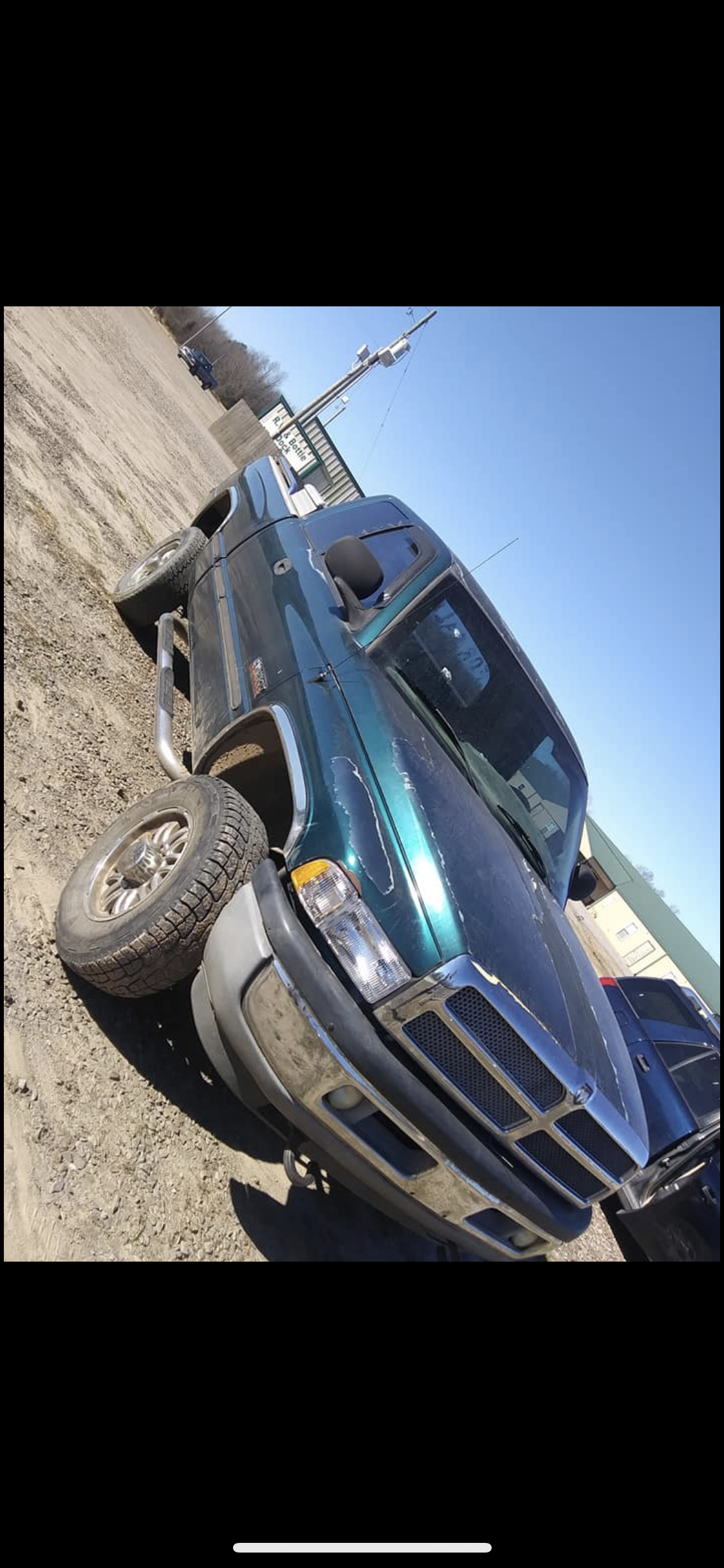

  13. Yes it was doing it before so I bought another one from rock auto and it had no voltage to set it at so I found somewere the basic voltage and set it there and it did the same thing ig I learned my lesson buying cheap parts but my timbo should be here today
