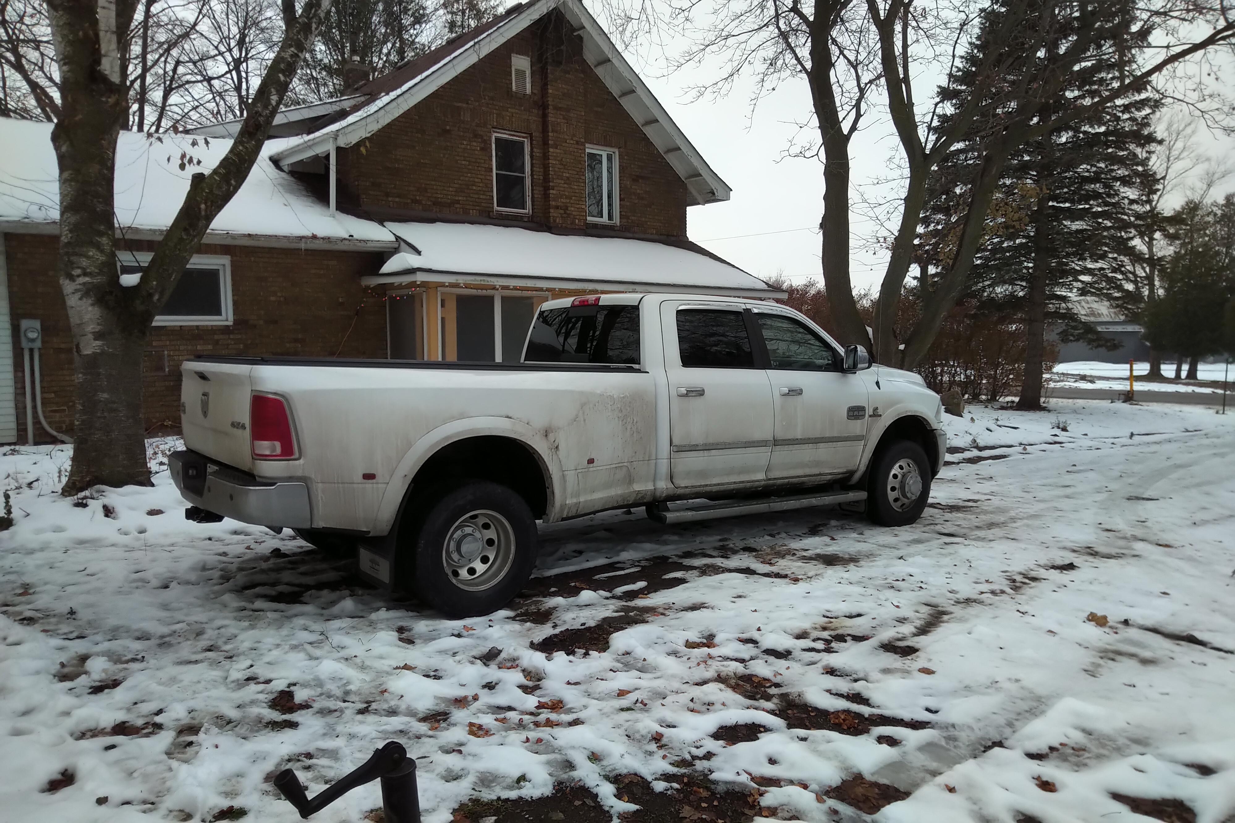

  8. I have been having troubles with my ABS system. Originally i had both rear speed sensors being the fault. Replaced them with mopar originals reset the code all was well for a couple days. Then it came back. I can see the rpm on all 4 wheel sensors with my scanner. Sometimes the right rear wheel shows no speed than normal. I have had it show NA for all wheels while driving. I have had the scanner loose communications with the ABS as if it wasn't there. I have had it go out on its own & then it screws up the digital speedo only to set the code again & my speedo goes back to normal. This week i pulled it into my shop. I have a little farm with a nice shop to work in. I disconnected both batteries & checked the connector on the ABS module. It was ok no corrosion. I then checked the wiring from the rear wheel sensors. I took apart the connectors underneath the cab behind the inner wheel fender. I put everything back together & started it up. My gear selector is bright yellow & i have a few error codes. I can't erase anything & the truck won't shift out of first. The truck was fine other than the ABS & traction control on before this. WTF. I am out in the country & this is my only ride.
