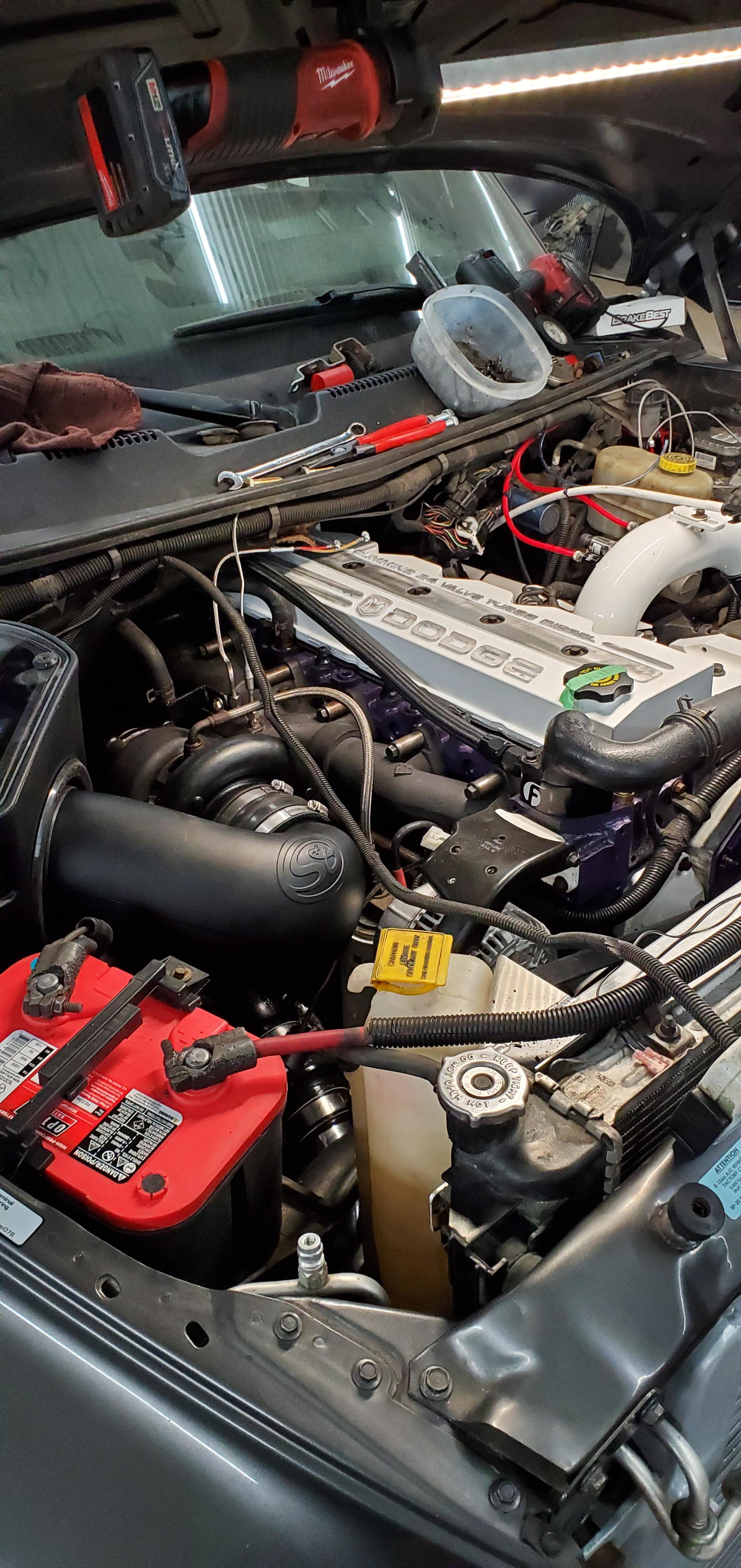

  23. Flexalite 252 cooling fan, 55gpm 12vdc coolant pump, fleece coolant bypass kit. New Cummins OEM oil pump, new optima red tops, fass lift pump with 1/2" lines etc etc About 50 grand Did a lot to the suspension and chassis, nv5600 and rest of the drivetrain. It was a comprehensive build. Now I just want the damn thing to run right lol
