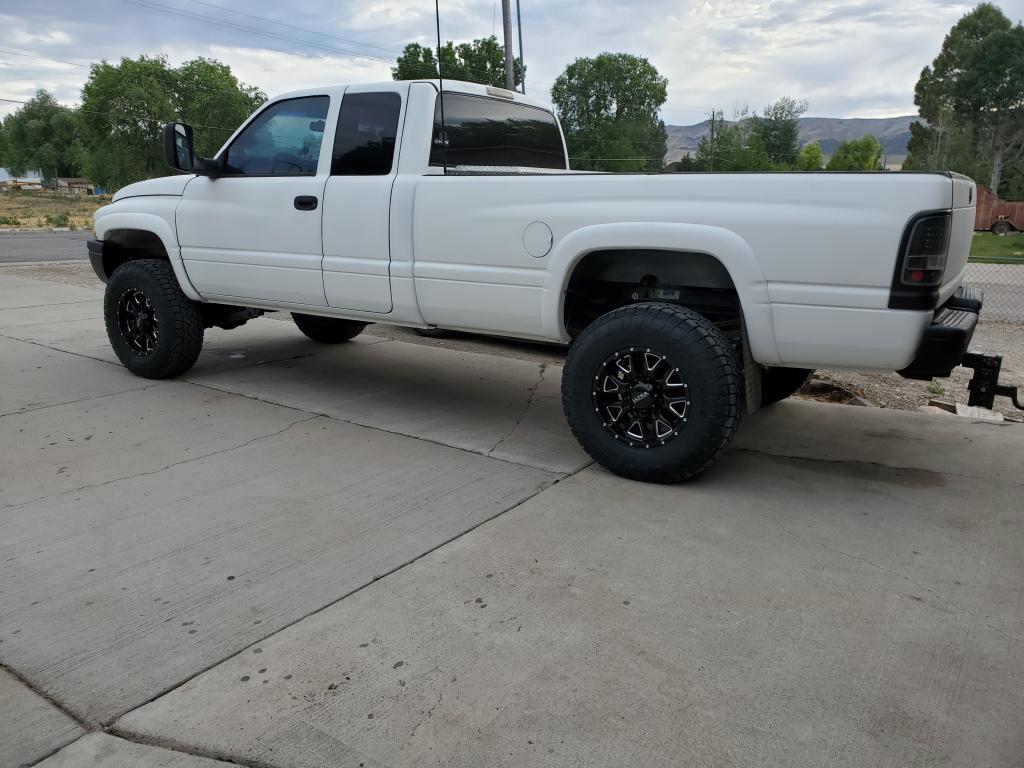

  5. After i posted and started going through all of the Quadzilla posts on here i figured that would be the recommendation. I have had the Smarty since 2015 and have loved it but maybe its time for a change. The only reason i have the Edge EZ is because a guy i know had it on his truck with his Smarty and said it was broke so he gave it to me. I'm pretty sure he was running timing with his Smarty also so they were fighting each other. I put it on my truck and switched my Smarty to a software without timing and it worked great. So i guess my new plan is replace the manifold, add a boost guage and Quadzilla. Once i sell the Smarty I will get new injectors then save up for turbo upgrades later. I know the tire size isn't ideal for towing but i really like this size on this truck and have ran this size for the last 100,000 miles. I average 16-18 mpg empty running 75-80 mph, towing my boat the last couple years I've been getting 12 mpg going 75-80 mph. I just picked up this new 5th wheel last month and got 13 mpg going 60-65 mph going up highway 6 in Spanish Fork canyon pulling some pretty good grades.
  6. It's been so long since I've been on here or posted I couldn't remember my user name so I had to sign up again. This forum has always been the best place for anything cummins and I need some advice. On my trip to Lake Powell this weekend towing my boat I started hearing an exhaust leak while under load. Turns out my manifold is cracked almost in half through the runner for cylinder 4. Almost all the miles I put on my truck anymore are either towing my 10,000lb 5th wheel, 5000lb? boat or just driving up in the mountains getting firewood or hunting. I've been looking at the DAP 3 piece, adding an Isspro boost guage and changing my autometer Pyro to an Isspro to match my fuel pressure guage. I would really like to upgrade my turbo and injectors but don't have the cash at the moment. I just dumped about $3500 on "paint" and new tires and wheels. If I just do the DAP 150 injectors will I have issues with egt's with the stock hx35 for the rest of the summer until I can upgrade to a better turbo? I'm currently running around 11-1200 pulling hills with occasional jumps to 1300 for a few seconds. I have my smarty on software number 6 and the edge ez controlling the timing. Should i wait on injectors until I can replace the turbo at the same time?
