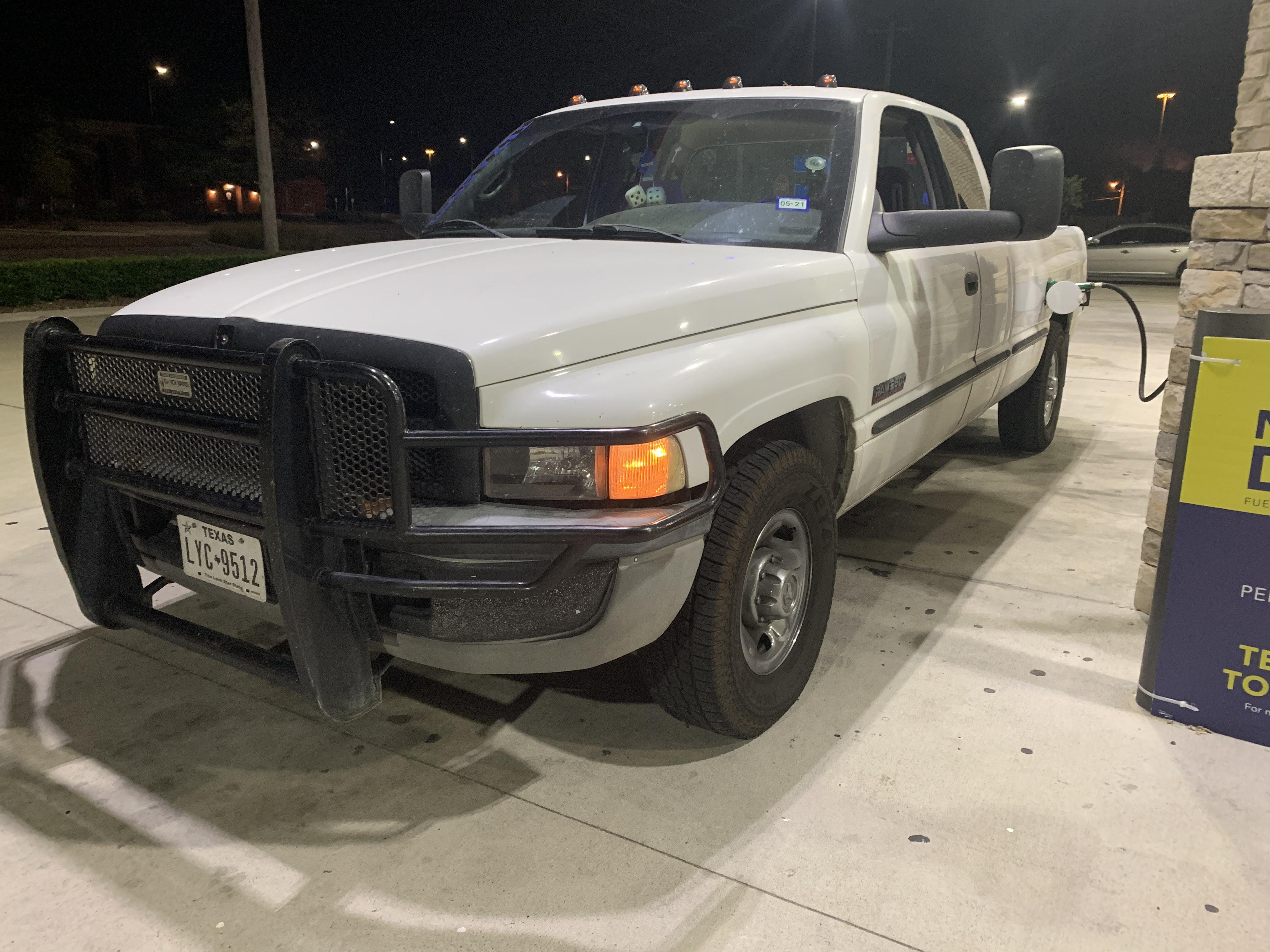

  1. A few days ago, I experienced a random dead pedal issue on my lunch break at work. I went to go grab some lunch and everything was fine. Got back to the job site and killed the engine to eat. When I went to start it back up, I put it into drive and started to take off through the parking lot. At the moment I started to put my foot on the pedal a little, I realized I had no response. I mashed it and still nothing. Long story short, called a roll off tow truck, when he got there, it worked again. 2 days later (replaced TPS that day), dead pedal again. Reading forums and stuff to find sequences, all fuses are good, CEL went away when I pulled a fuse to test voltage on. Put it back in and the CEL went away and my WTS light started working again. First time doing a sequence, nothing. During the second time I cleaned my MAPS sensor and put it back in. Fired her up and had my pedal back. Drove it home and it has been parked for a good 16 hours now. Took batteries off to go test them. Batteries are good according to Oreilly’s. Im at a loss here. I dont know if I need a new MAPS sensor, VP-44 or what. I would just replace both but the shop I’d drop my truck off with will charge me $2200 for a VP-44 and the labor. Any help would be appreciated
