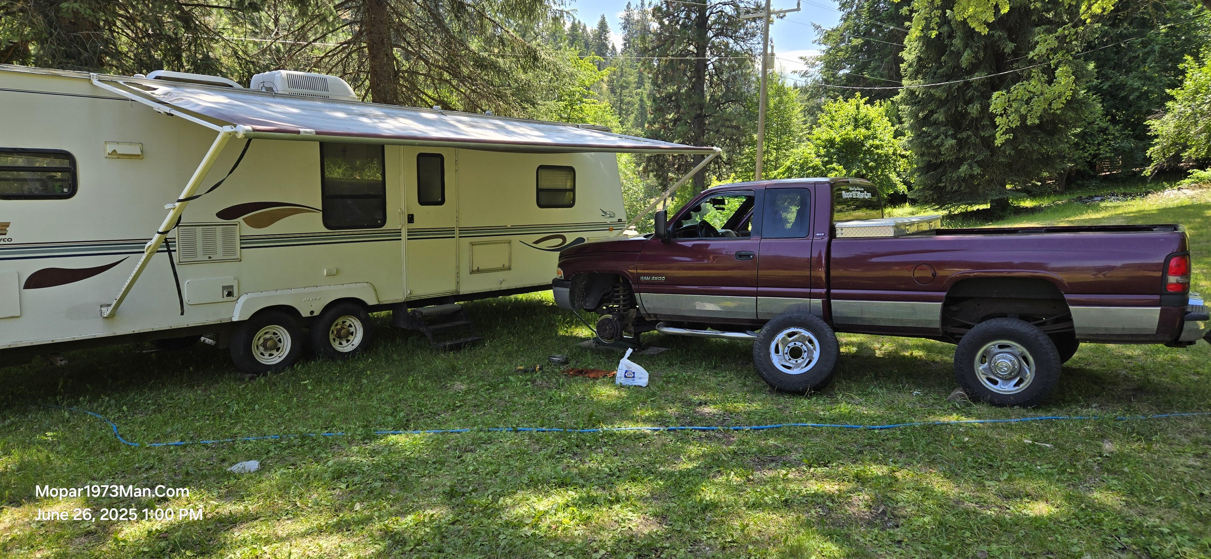

Yeah, I just got done doing brakes on Beast. Both rear brake calipers had rusted pistons that were so jammed that I couldn't seat them. @Tweety Bird was telling me just get it repaired, we need the trucks to function properly. I most likely got a little tear in the rubber boots, and the road salt finally ate the calipers up before the pads were even worn out on the passenger side. The driver's side rear pads were nearly gone due to the rusted pistons. In my position, without a shop, it makes it
Both @Tweety Bird and I gotta have a break from all this. I had to deal with rusted slide pins on the calipers front and rear axle. We managed to find enough of my tools to at least do a simple repair. Suzanna has been busy packing the RV so we can go take a break camping locally. I'm kind of amazed. Got the front brakes done with slide pins. Both side you had to beat the pins out of the boots. The last time I did brakes at 350k miles till now with 497k miles and rolling. Finished this project
