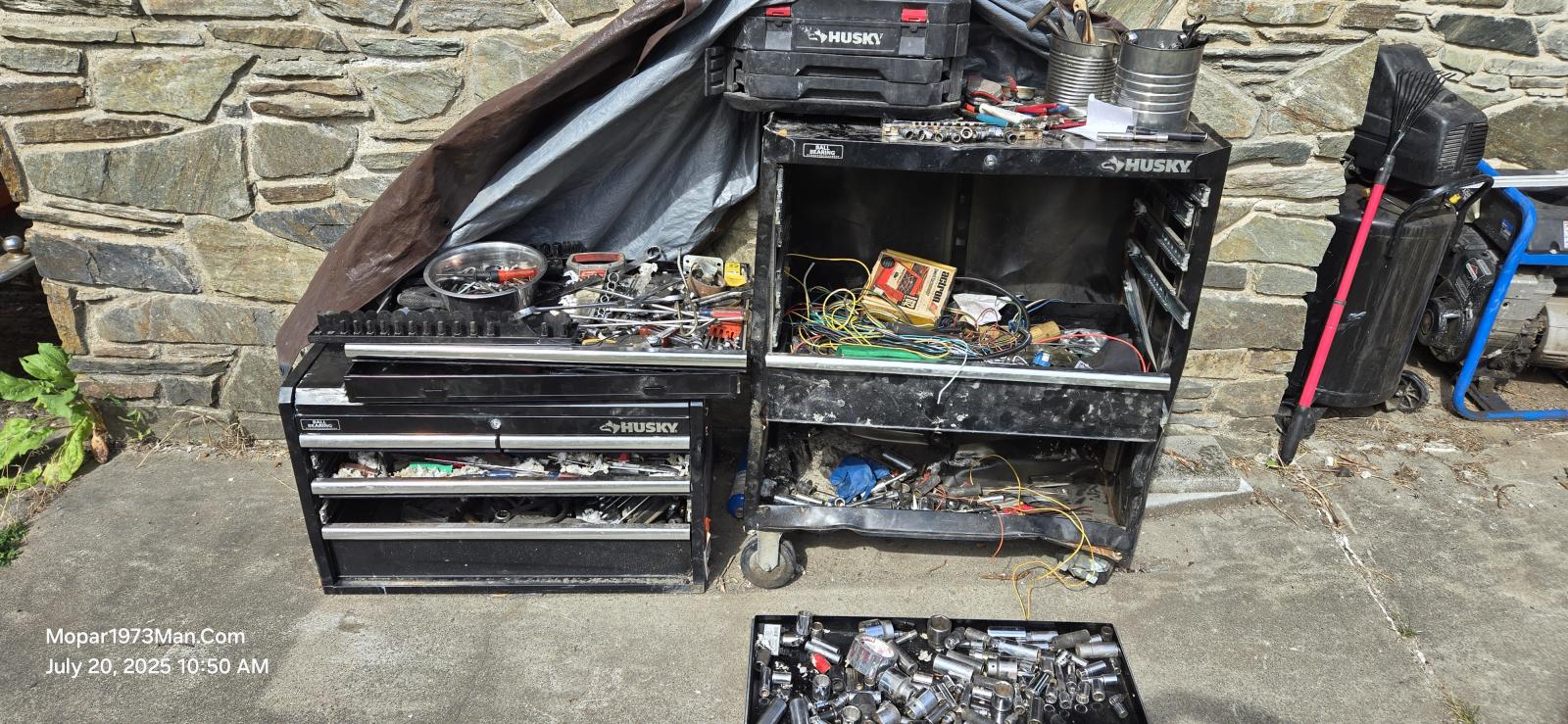

A simple job like this should be much more than a few minutes to fix. When your tools are all scattered and the box is in ruins. We are still missing sockets and tools in the dirt of the yard. Highly frustrating to spend nearly an hour to find 1 socket, 1 ratchet, and just take the fitting out and modify a spring. Absolutely frustrating!
