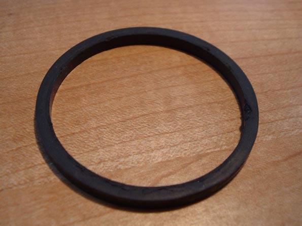

On from caliper be sure to check the piston seals if there has been any debris behind the weather boot. Take notice to the picture below. There is chunks of rubber missing from the seal this is cause from debris being caught between the piston and the seal. Pistons and seal can be purchased only through a Dodge dealer but they are not expensive.
damaged-caliper-seal.jpg.7342b9cd00a220c
