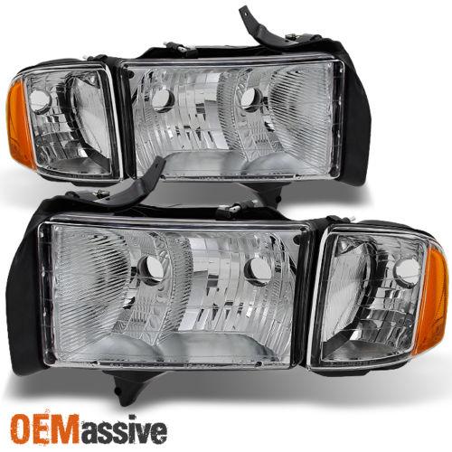

 Sport Housings
I decided to jump to sport lights in the middle of this process.  These are the lights I got from Ebay.  I am VERY happy with them.
Amazon Sport Headlight Housings Link PN: 55077025ac 55077025AG
s-l500.jpg.4eac301f17f9a8b9f029241212687
They required a little cutting to get the projectors set in them, but nothing bad.  You can get extended threads projectors so I would suggest that.
