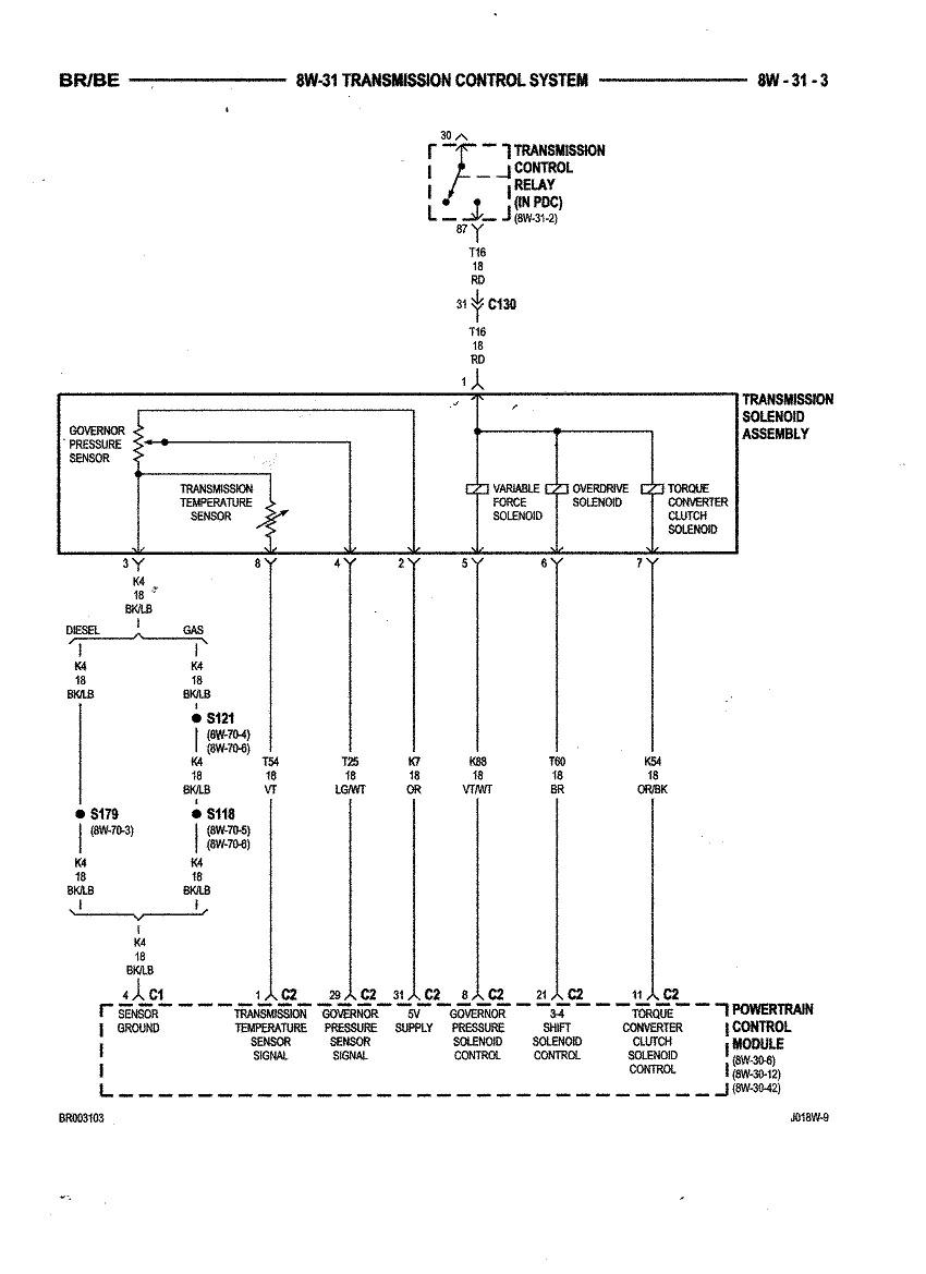

This wasn't converted from factory been using the diagrams posted on here everything is pretty much the same other than wires being extended
OK,  The O/D switch is a momentary type,  when pushed it switches a transistor relay in the PCM, then the ground for the O/D light is completed and the ground for the O/D solenoid is removed (open circuit) push it again and the ground for the light is removed (open circuit) and the ground for the O/D solenoid is closed.  The light get its power from fuse #14 in the junction block.  If you have good power and grounds for the PCM, the wires from the PCM to the switch, instrument cluster, and trans mission all test good the it has to be the PCM.
1145532600_Scan_20190623(2).jpg.cafb9aa4aff88cb700478f66632b6aed.jpg       Scan_20190623.jpg.47fea34aec6420a711f97119e510f3f2.jpg
