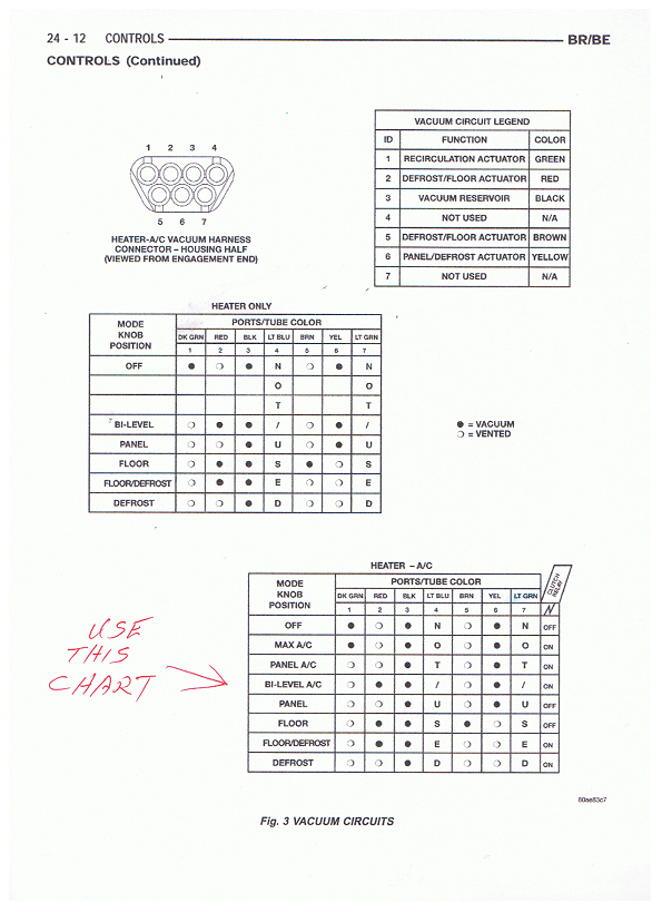

Last week switched to defrost now I can't get the A/C to come out the dash vents, air is all directed to the floor, When on A/C  I checked the actuator that's behind the glove box, it has vacuum and draws the vent closed. The actuator toward the firewall also has vacuum and works, the lower actuator that has two vacuum lines has no vacuum. Any one know if the lower actuator should have vacuum and to which line?

Thx, From this chart I think the switch went bad, the yellow line has no vacuum if my memory is right and that's on the lower actuator. Now when we get back home I'll recheck then off to U-pull-it. Need a Light switch also, headlights sometimes don't come on, and a Pass Seat for the drivers side.

Yea that's all that ever shows up in the u-pull-it in my town.  Thx again for the diagram
