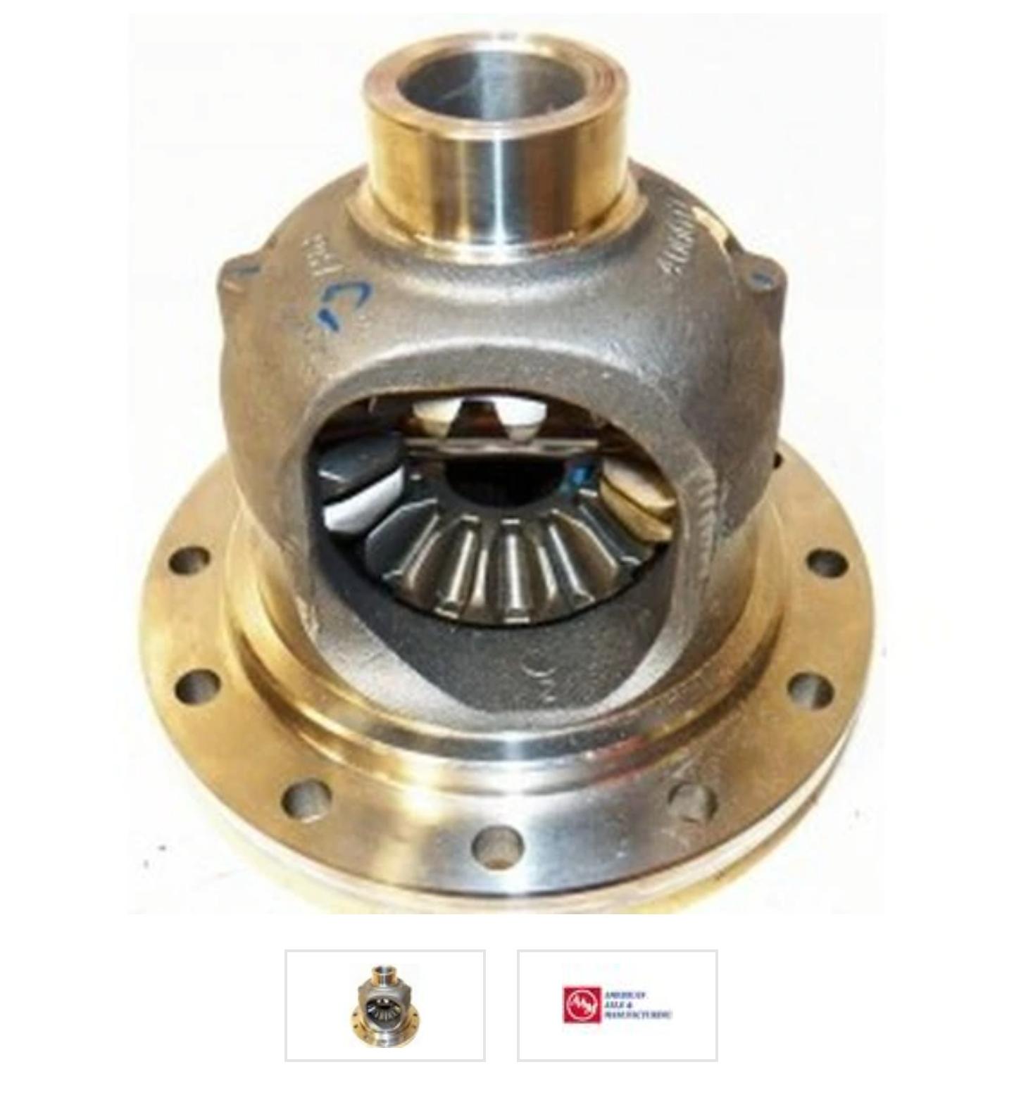

Pic of that new part number for the open Diff.
40146894
