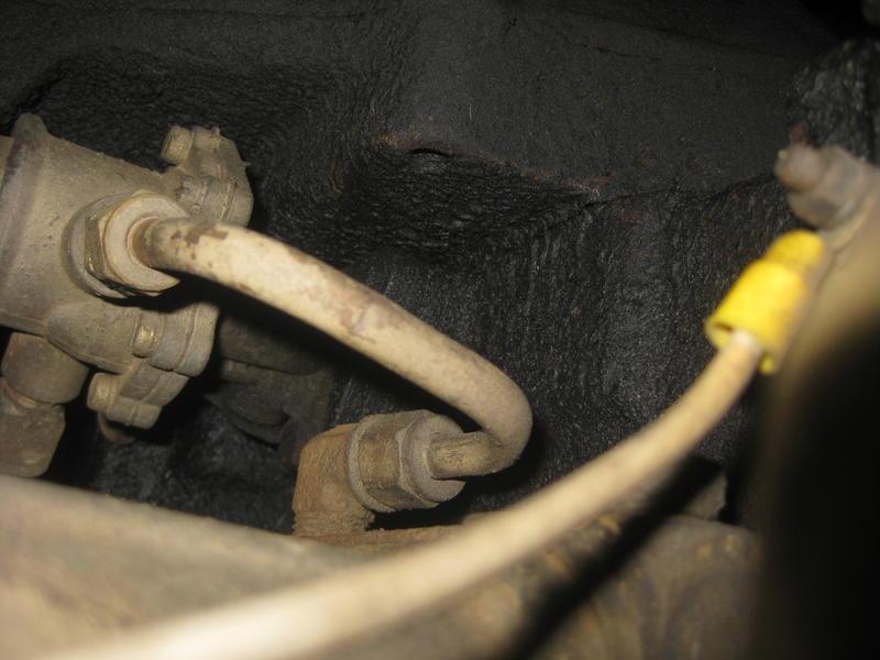

According to this site it can be used, same engine and everything so I don't see why it wouldn't work: http://www.4btswaps.com/forum/showthread.php?32-FAQ-Commonly-Asked-Questions-4BT-Files-Pics-Links-PART-s-BOOKMARK-THIS-THREAD I think the connector you are looking at is just a fancy compression fitting. It basically goes on just like the injector line nuts. Let me find some pics that you can say yay or nay to on how it looks. Yes the engine has a cam lobe that pushes on that lift pump "pumping" it. Do the fittings look like the ones in the pic? They are the fancy compression ones.. just unscrew them all the way then the line pops out.
Nope, the supply line fitting that feeds the lift pump is nothing like that.
The fuel out line to the IP is just a standard compression fitting, but not the line feeding the lift pump? :shrug:
