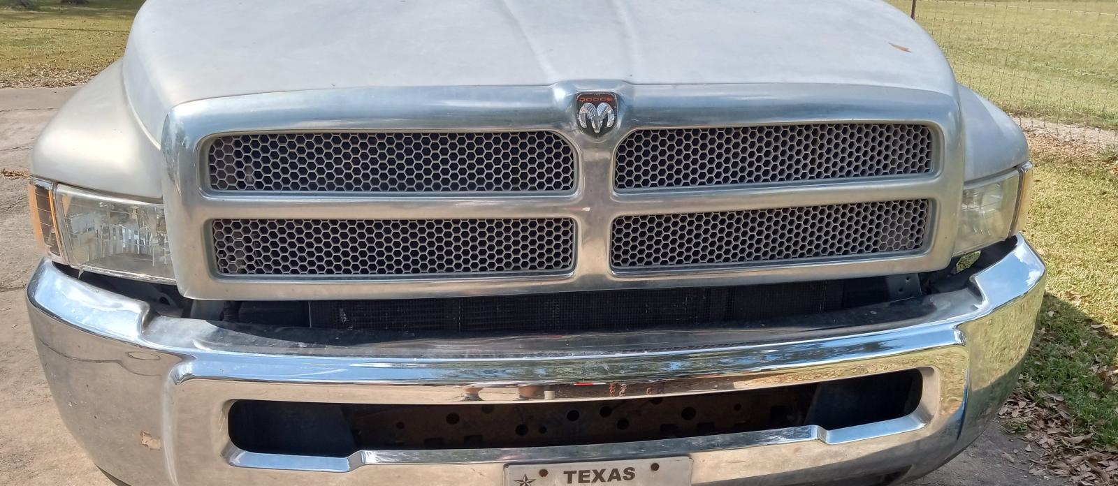

Yours looks a lot better than mine. I guess its all in the brackets. I got mine like this, so no idea about it. I can't adjust it any better than it is with the holes it has that I can tell.
You need to get a sports grill for it. This is what mine looked like before I put the sports grill on it. This is the regular grill. Everything is black but if you zoom in you can see the gap IMG_1446.jpeg
The sports grill I got was about 1 3/4 “ taller from top to bottom. and was thicker.
Yeah, that'd make a difference. Your gap under the headlights is better than mine too though. Nice looking truck. Looks like another nice one next to it.
