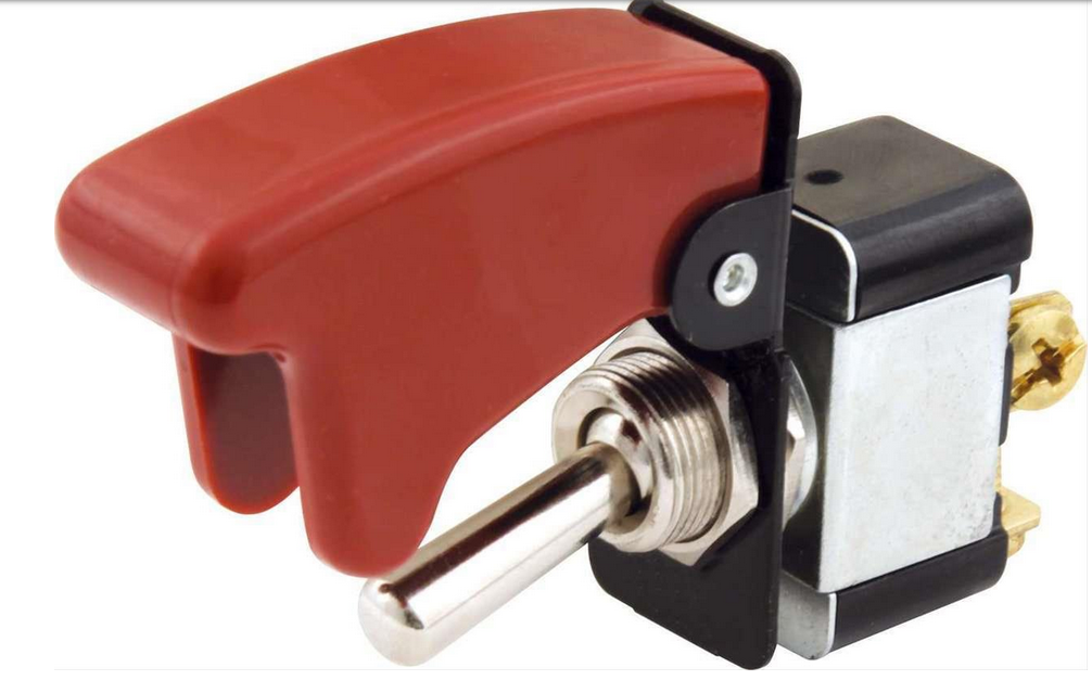

  • Toggle switch - two position maintained switch with physical lockout

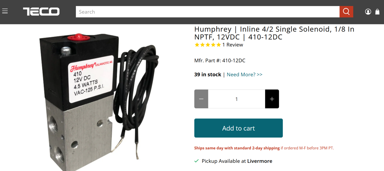

  • Humphrey 4 way / 2 position, 1/8" NPT, spring offset, vacuum solenoid valve Model 410/12 VDC

This conversion separates the operation of the transfer case manual shifter and the CAD vacuum controlled shifter. The external vacuum ports of the vacuum valve (inside the transfer case) will be disconnected and plugged. A new vacuum solenoid valve for the CAD unit operation will be installed in a location of choice. A fused switch will be installed to operate the new CAD vacuum solenoid valve. A vacuum supply line will be routed to the CAD vacuum solenoid valve. Two vacuum lines will be installed to connect the new CAD vacuum solenoid valve to the CAD unit.

The CAD switch has a physical lockout to reduce the chance of accidental operation. When the switch not going to be used, always engage the lockout with the switch in the "Off" position.
