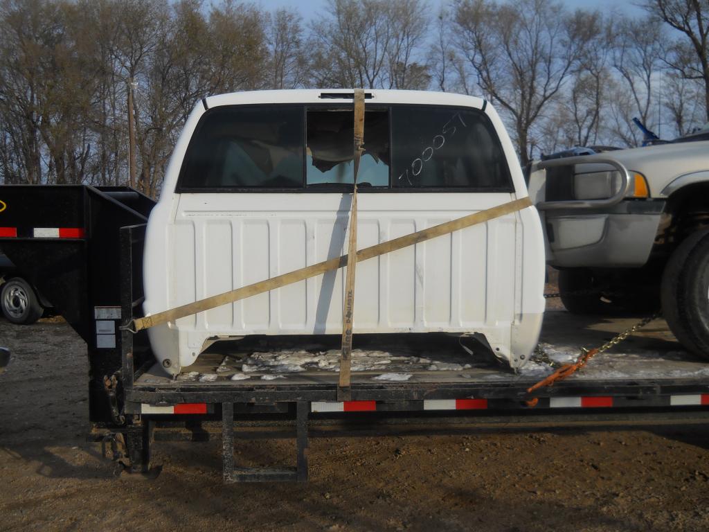

:spend:Got home last night with my '98 (I was misinformed, I originally thought it was a '97) This truck was originally sold new in Littleton Colo, and spent most of it's life in Colorado, and ended up in the Panhandle of Nebraska. Salt wasn't much of a factor on this truck. Doesnt really matter to me though, cause it was rolled on it's side. I got it mainly for donating everything I need (driveline wise) into my '94This truck came with the snow plow option and tow package. It's got the Dana 80 rear with limited slip 3.54's DHD Tc, It was a nv4500 (now missing). Extended cab, long box. I got a good cab and box as part of the deal.... which I won't need... (For sale!!)Options it came with are pw ps ac cc AND, an undeployed air bag!!! Plus, LOL, 3/4 tank of fuel! whoo, that's 75 bucks recouped right there!It's amazing the pile of parts that come out of a dismantled cab..... I'll bet there is an unclaimed lotto ticket in that pile somewhere!!!:thumbup2: Thank goodness I have a couple of parts trucks on hand to donate screws, bolts, clips.... etc Soon as wife finds the camera, I'll get some pics before I unload the beast... and LET THE GAMES BEGIN!!
